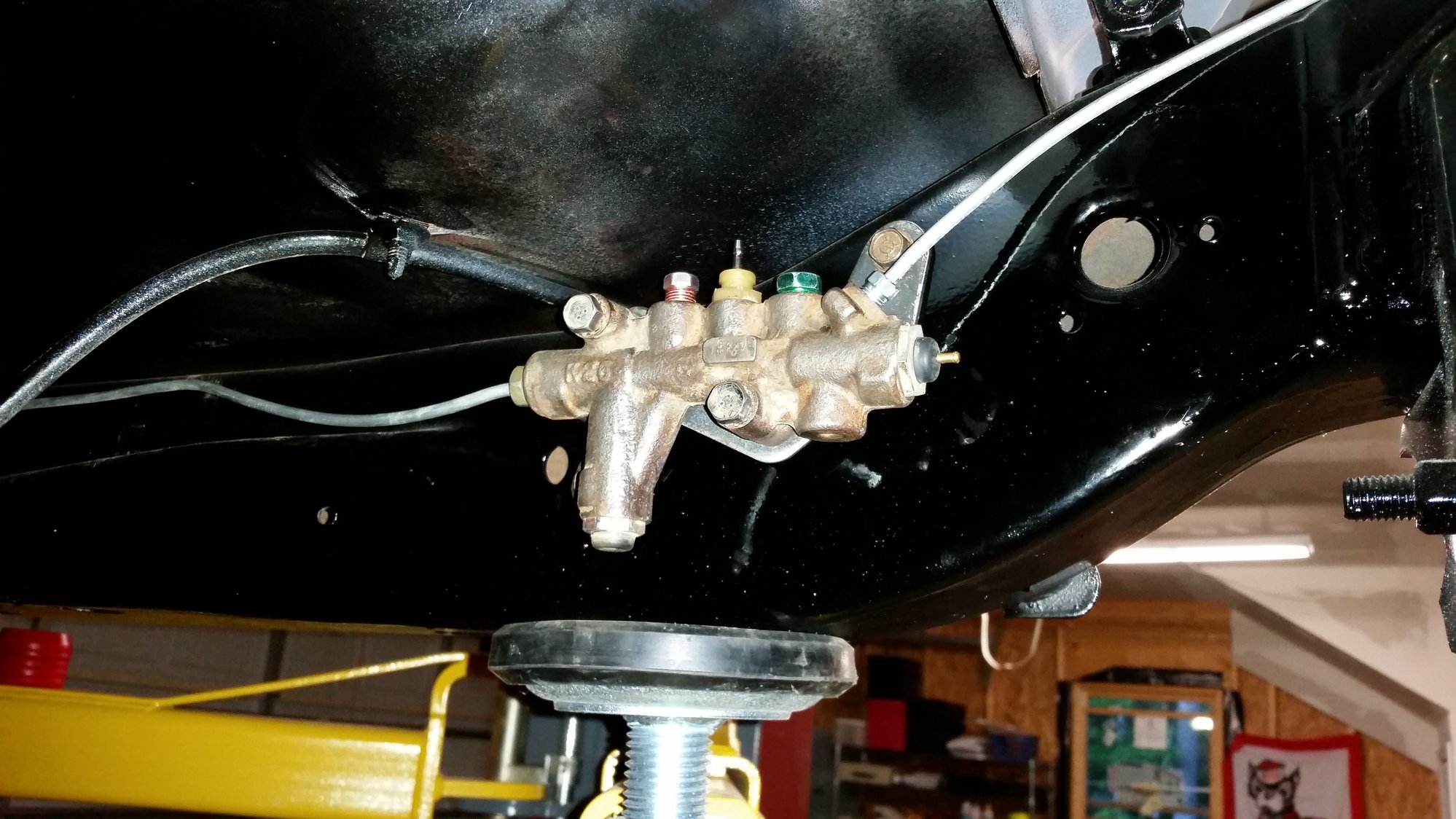

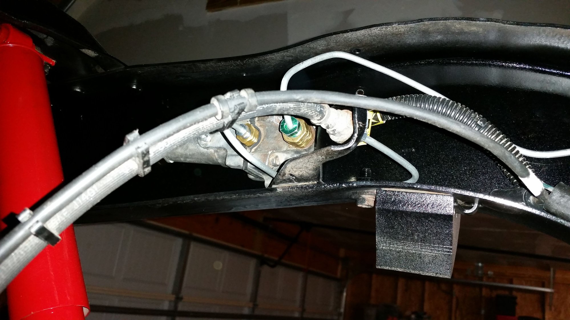

Yep, I did exactly that....flared every end, and not a single crack or blown flare. Bending was easy too as I used a tube bender and zip tied the lines to the old ones as a template. I'll disagree with Ralph a little here, as the stainless was neither difficult to bend or flare. Use the OEM in line flare tool, not the clamp style. Didn't mess up a single flare. I over tightened one and cracked it, but with the OEM tool I repaired it without removing it....easy peasy.

All new lines front and rear proportioning
