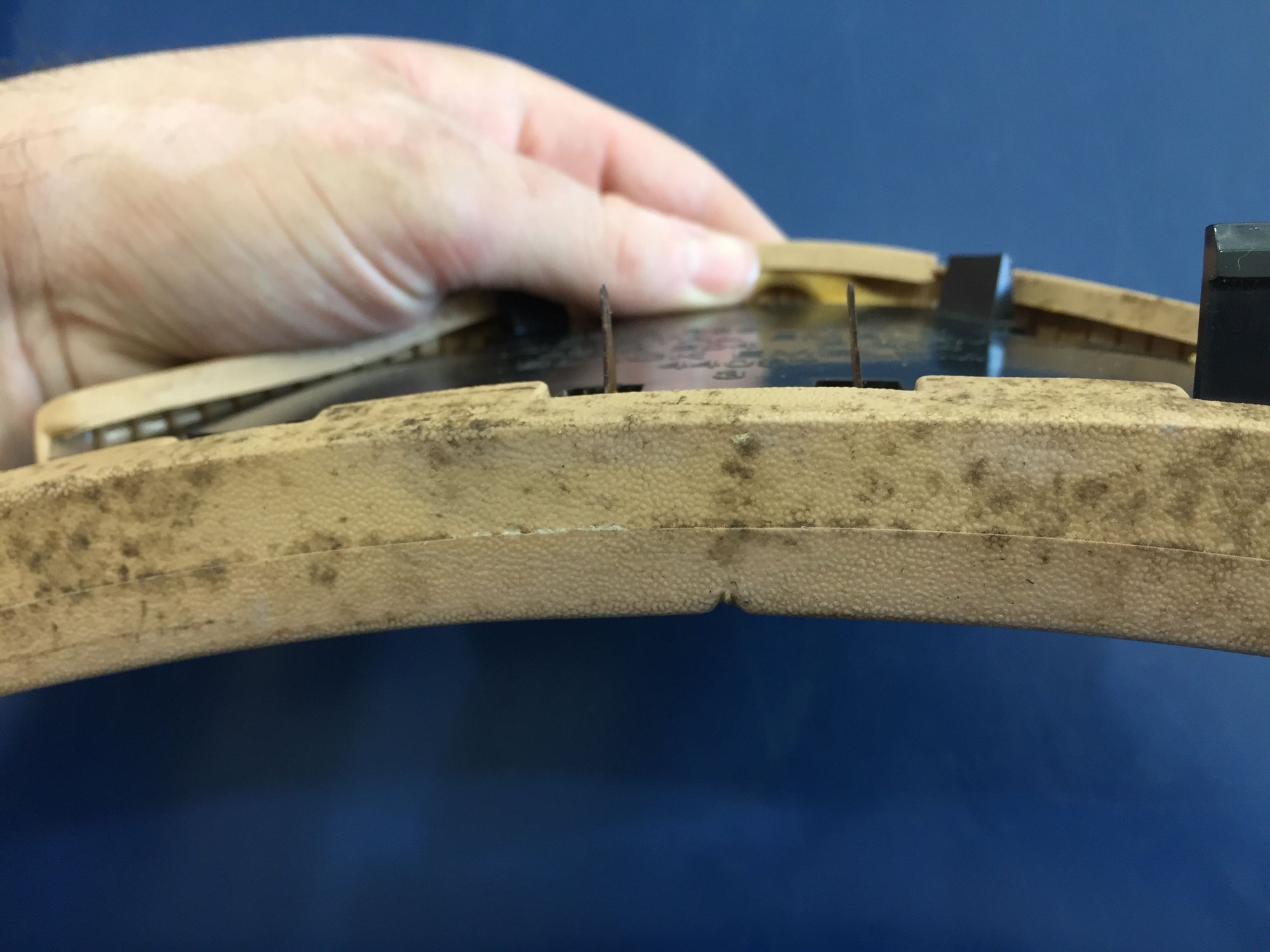

Old Oct 4, 2017 | 12:05 PM
Josh89Griffin's Avatar
Josh89Griffin
Joined: Apr 2017
Posts: 167
From: South Georgia
Here are some pictures of the horn pad and the relay. While I inserted a new relay into the fuse panel, with the 2 wires unplugged from the horn pad, the horn started to blow when I pushed the new relay into the fuse panel. With the 2 wires unplugged from the pad, I pushed the old relay in the fuse pane, nothing happend. Any idea what the problem could be?! Thanks!
Old Oct 4, 2017 | 02:38 PM
robertmee's Avatar
robertmee
Joined: Aug 2013
Posts: 1,033
Assuming you put the same style relay in, then if the horn blew as soon as you pushed the relay into the socket, then you have a short on the ground wire from the steering column to the relay socket, or a short at the socket itself.
Old Oct 4, 2017 | 03:46 PM
Josh89Griffin
Joined: Apr 2017
Posts: 167
From: South Georgia
I would need to replace that ground wire, correct? If that is the problem.
