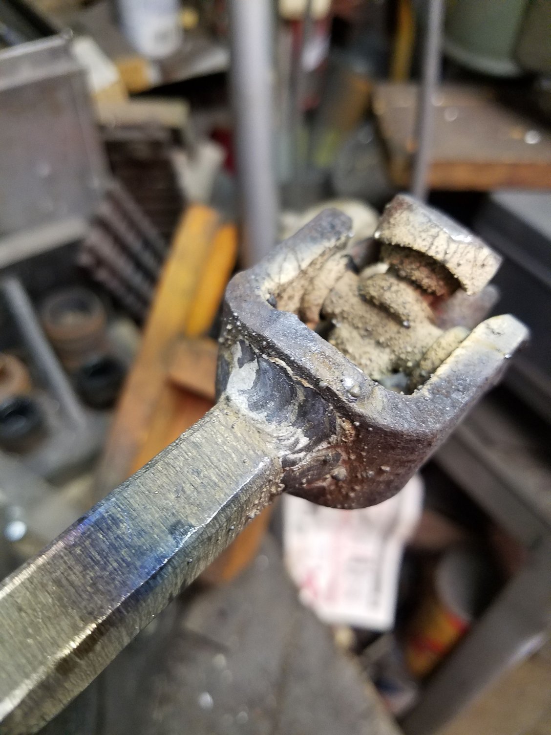

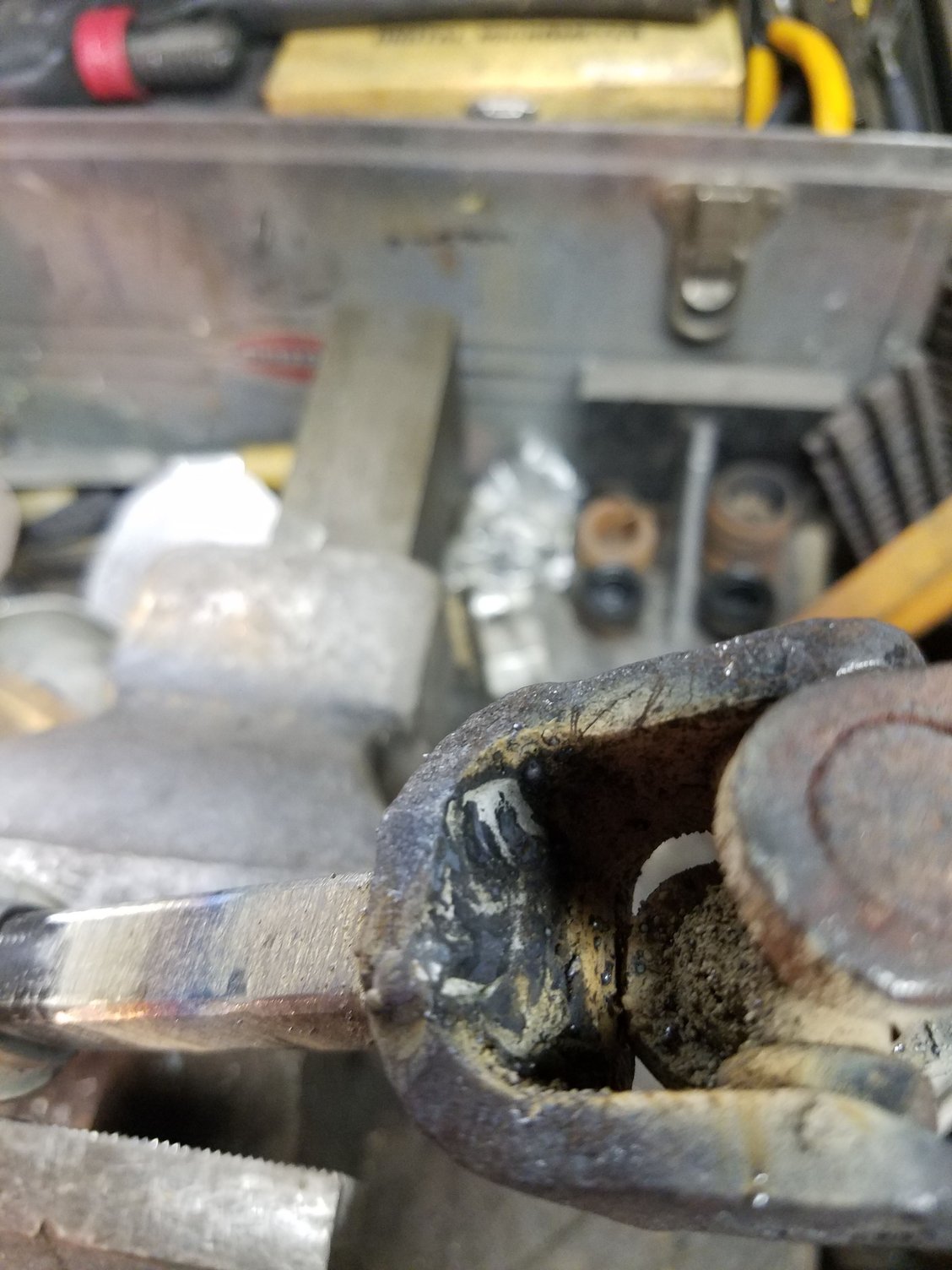

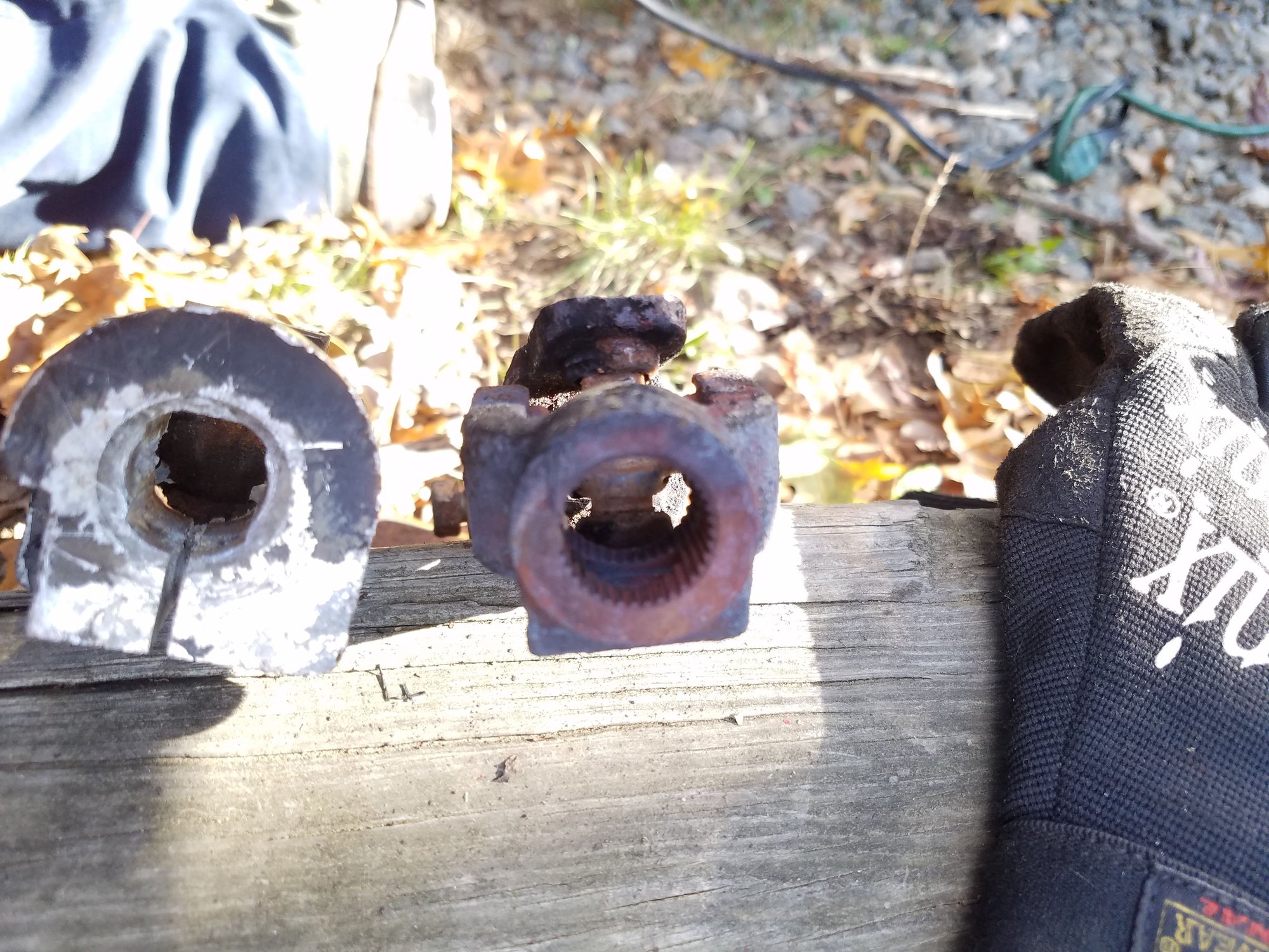

Well I managed to get the shaft off. Some daylight and an oxyacetelyne torch helped but it still put up a fight. No way would it have come off without the torch...
so as for the picture, how sure are you guys that the shafts are interchangable? The lower end for the box is the same. The upper end for the column is completely different. The stock shaft is a splined shaft, the newer bolt in one has 4 "corners" to it and is much smaller. No chance of it fitting... So the real question is, now what?
Old Nov 15, 2017 | 02:28 PM
marcar1993's Avatar
marcar1993
Posts: 533
So i have answered my own question. I decided since the u joints are still good and I don' really care to spend money on this truck that id cut the old end off and weld it to the new shaft.
I cut the ends off both shafts on a bandsaw then slipped the old end on the new shaft.
The old shaft was a hex at the end and the new one is rectangular so I lined it up best I could putting a rectangle in a hex hole... and then welded it on both in and outside. I think that'l hold it pretty well.
now I just have to find one of the roll pins that fell to the gravel when I drove them out to put it all back together.
