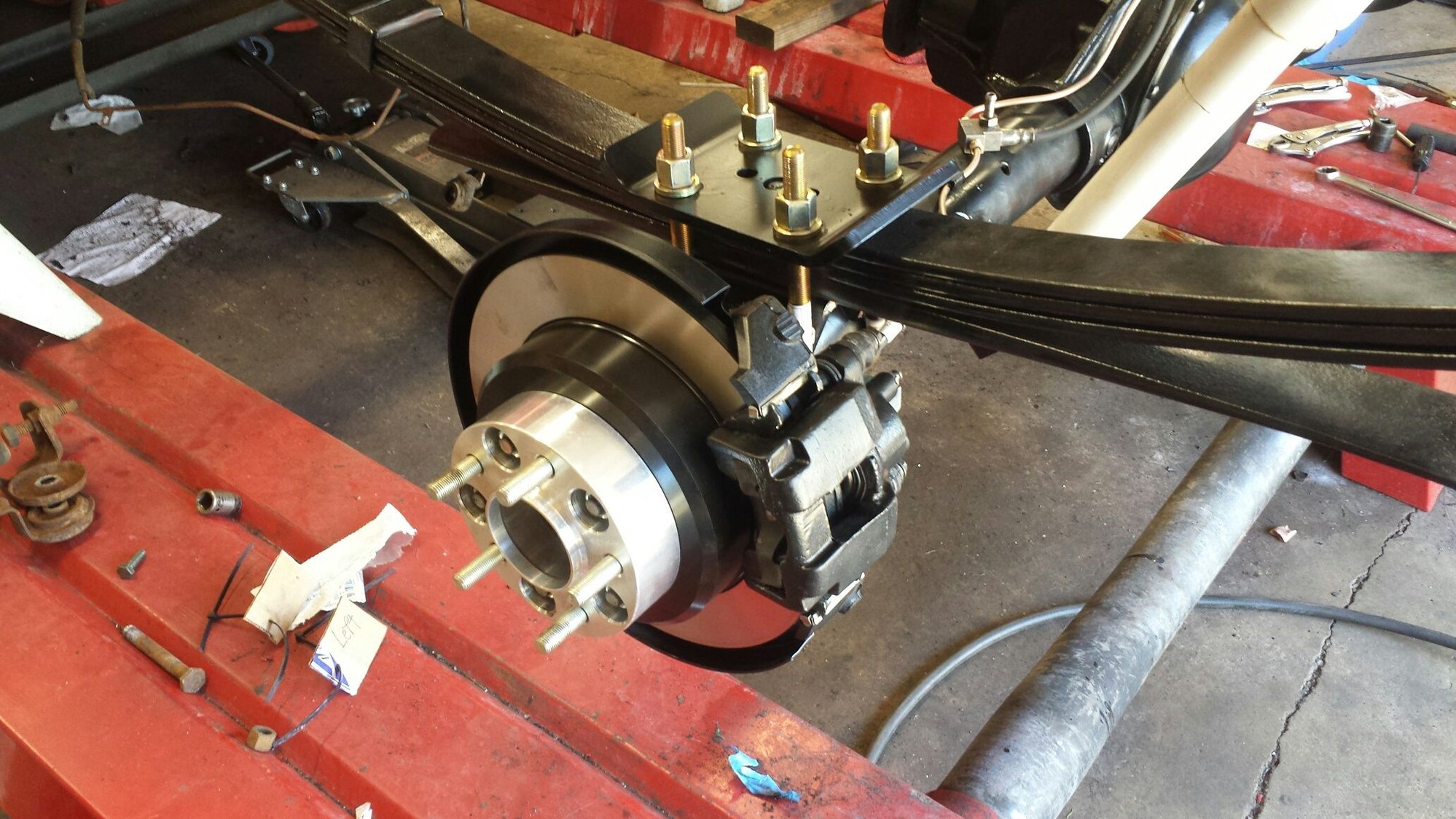

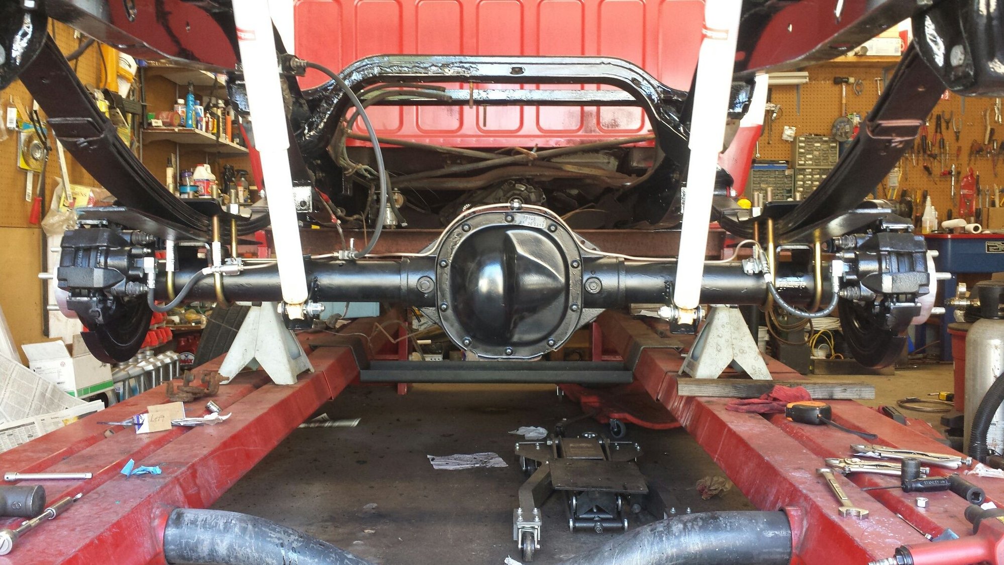

For the past 2+ months, in my spare time, I have been installing a 2000 explorer 8.8 rear in my 87 dakota.
Still have to figure out parking brake cables, connect brake line to the front, etc. I got a conversion u-joint.....
Have to reinstall gas tank, exhaust, hitch, wire loom, and of course the bed.
Hopefully will finish up this weekend, provided work, life, etc. dont get in the way!!
Once finished I will post more pictures, and details.
But wanted to share a couple of pictures of what I have done so far!

I had purchased this rear several years ago for another project, but that fell through.
Its a 3.55 ratio, my 8.25 was a 3.54. But the 8.25 had rusted backing plates, leaking seal, bad wheel bearing on one side, and the posi unit was wore out.
This unit is not a posi., for now, I just replaced the 2 outer wheel seals, rebuilt the calipers, new hoses, rotors, brake shoes, and pads.
If all works well, eventually I will put a factory posi unit in it.
One of the good things with the 8.8, parts are cheap. The factory posi is just over $200.00

This was my experience on pricing parts.
1. dana carrier on rock auto for a 87 dakota. $440.00 + shipping. Ford racing. 31 spline carrier's are available from several places for $229.00 shipped.
2. Backing plates, cant find any new one's and used are rare in good condition. Mine actually have rust holes in them.
3. Wheel bearings, seals, brake shoes, wheel cyl. I feel sure are available at a reasonable price.
4. In my area, first gen dakota's are rare in the junkyards.
I believe the posi carrier, in my truck, was used from 96 back. (at least according to rock auto site)
Backing plates, I have no idea what all will interchange.
Axles are good only for 87-90.
Reasons I choose to try a 8.8 rear.
1. Already had the rear end. Purchased it for another project several years back and that fell through.
2. The 8.8 is stronger then the 8.25
3. Axles are a larger dia. and are 31 spline vs. 27.
4. Overall, I believe parts are cheaper, and more available.
5. Has disc brakes. ( and I know this blessing could turn out to be a curse!! but time will tell)
6. To try something different!
This truck is not a daily driver. In fact, it has 83,xxx miles on it.
I have already upgraded the transmission from the nv2500 to a nv3500 and in time, I plan to put a 5.9 mag. with some mods in it.
Did it "need" a 8.8 rear? No,
At the end of the day, I probably did not save much, assuming I found good backing plates,
I believe I will have a better rear end.... but time will tell.
At this point, its a toy, and I just playing.....

Thanks for the pointers!! But mine actually has the open rearend in it now. Im going to leave it for now, and make sure the rear works well in the truck, ie. disc brakes, pinion angle set correctly, etc.
The carrier I am looking at is this. https://www.ebay.com/itm/NEW-FORD-RA...5Wi-pV&vxp=mtr
Says its orig. equipment in 03-04 31 spline cobra's
FWIW the only thing I seen wrong with the 8.8 rear I have was , 1 wheel seal was starting to leak , and the parking brake shoes were shot. I though the rotors were wore out, but turns out that what I thought was wear, is actually the way they were made. I did rebuild both calipers, new pads, shoes, rotors, and 2 seals.
On your g body conversion, Did you make it up yourself? Looks good!! I noticed you welded the tubes in as well.
