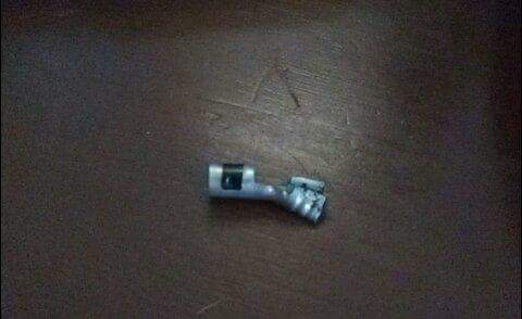

Stopping here, before YoouTubing this. Changed the spark plugs a few minutes ago on the Dakota, or I should say I changed 5 out of the 6. On #6 I broke the boot, the part that connects the plus to the boot, did not notice it until the socket did not go all the way down. Now that socket is stuck, of course "Murphy's Law it is the hardest to get to plug, the driver's side rear, near the cab.

Went out with my dad, we were trying to get the socket off and it dropped down totally around the plug, so just the broken part was left exposed, was able to get a grip with some needle nose vise grips and get it off. Plug is switched out, need to get wires next, luckily O'Riellys and Auto Zone are within a mile, so an easy walk.
