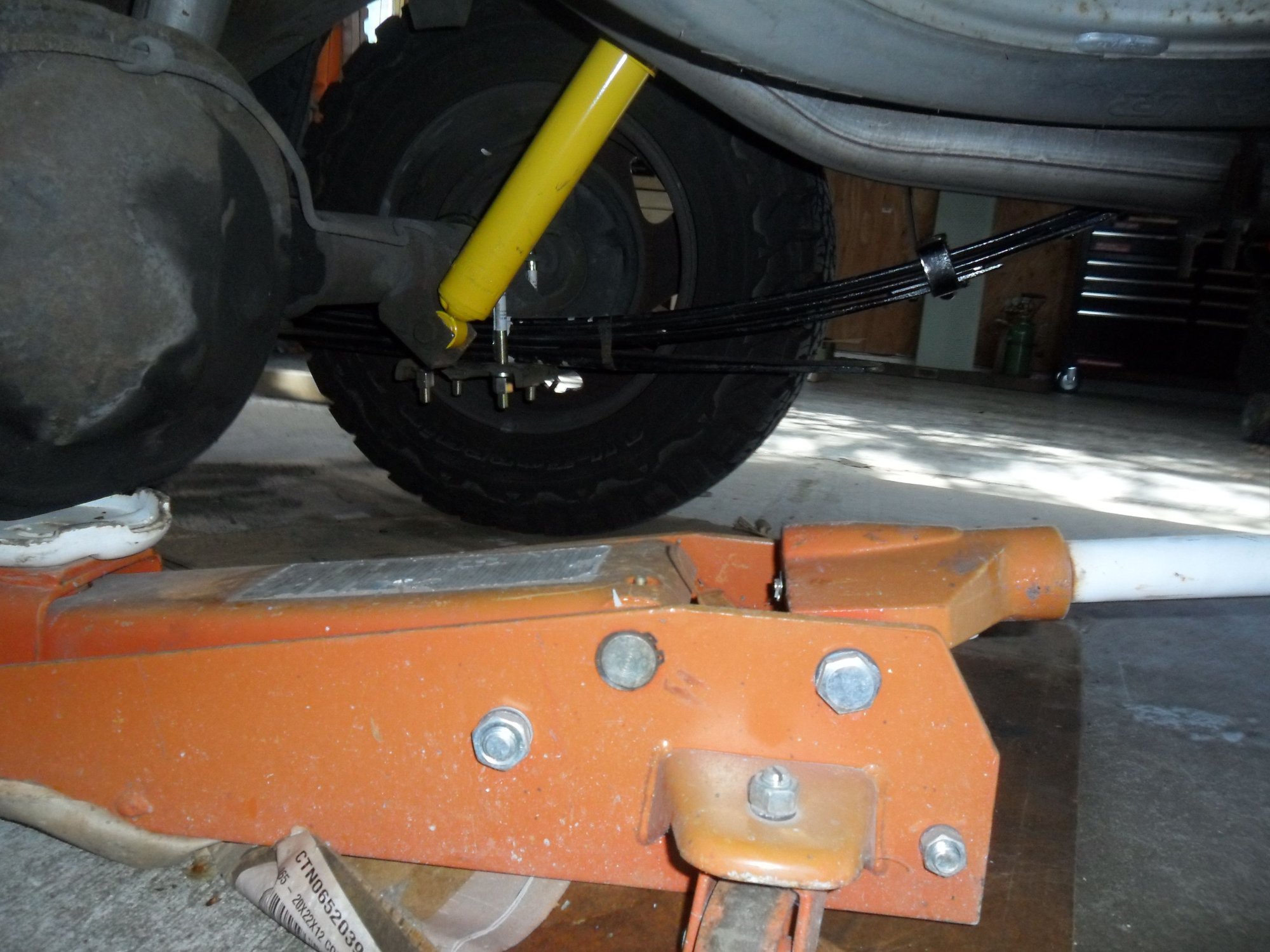

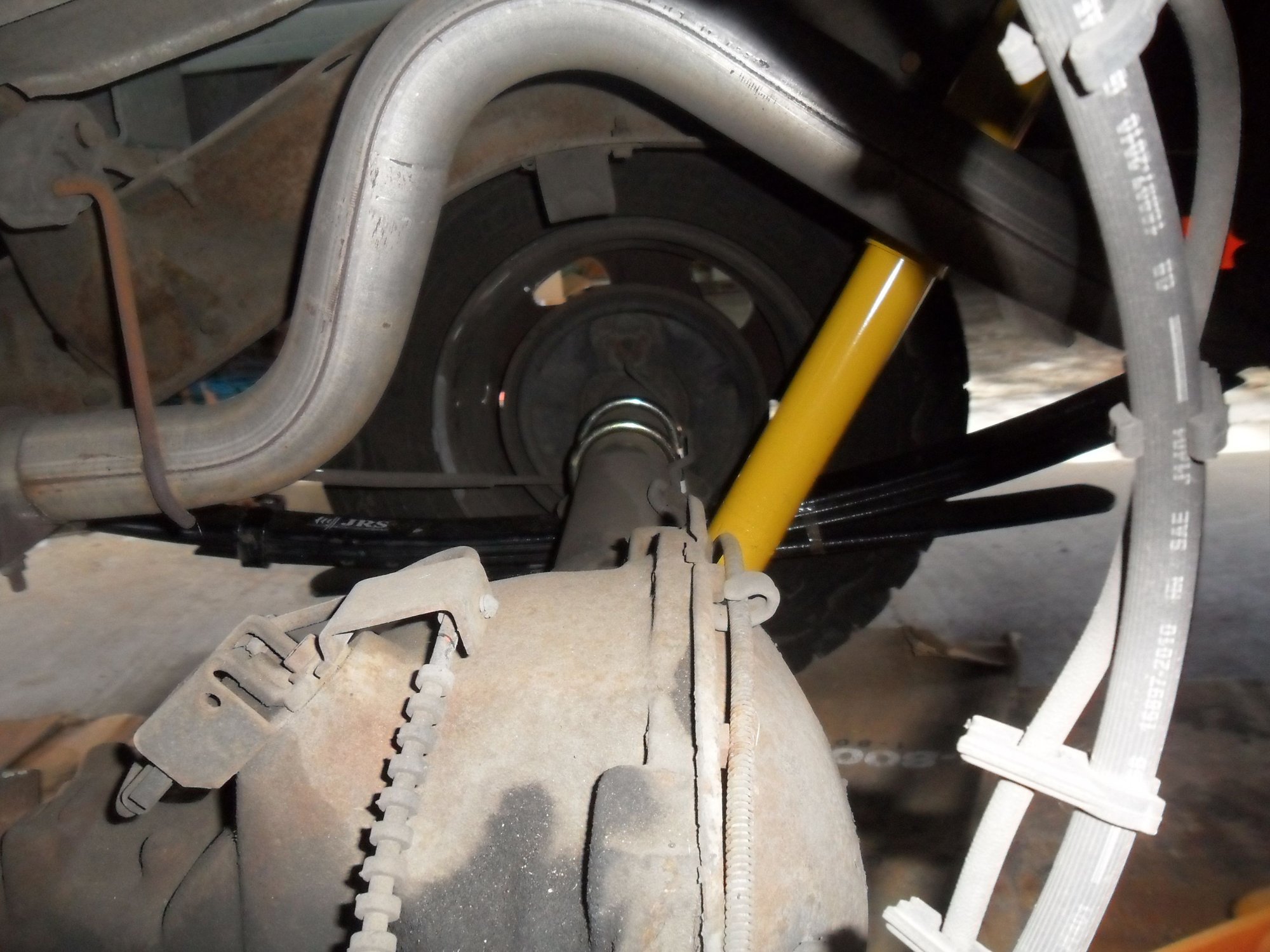

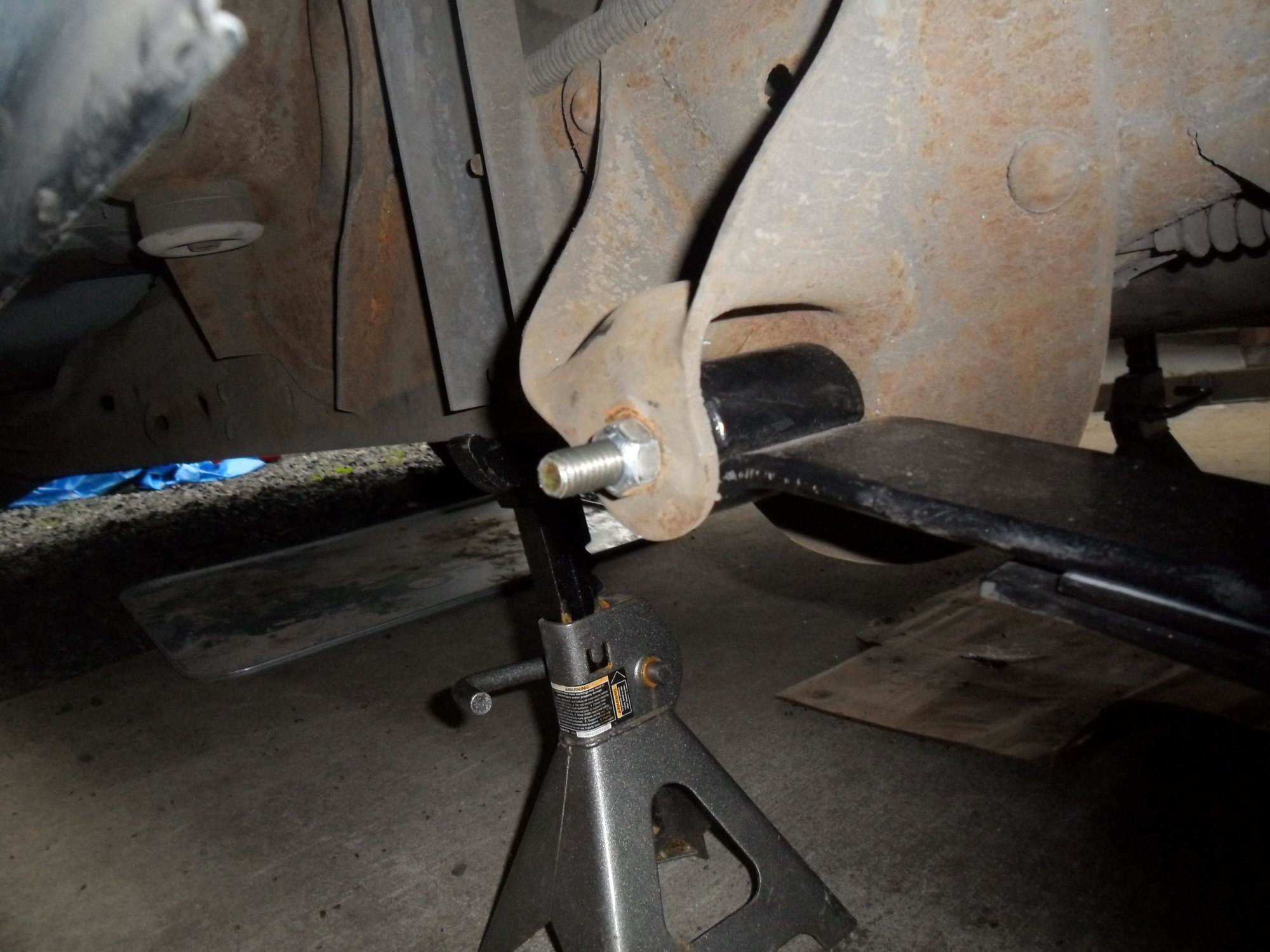

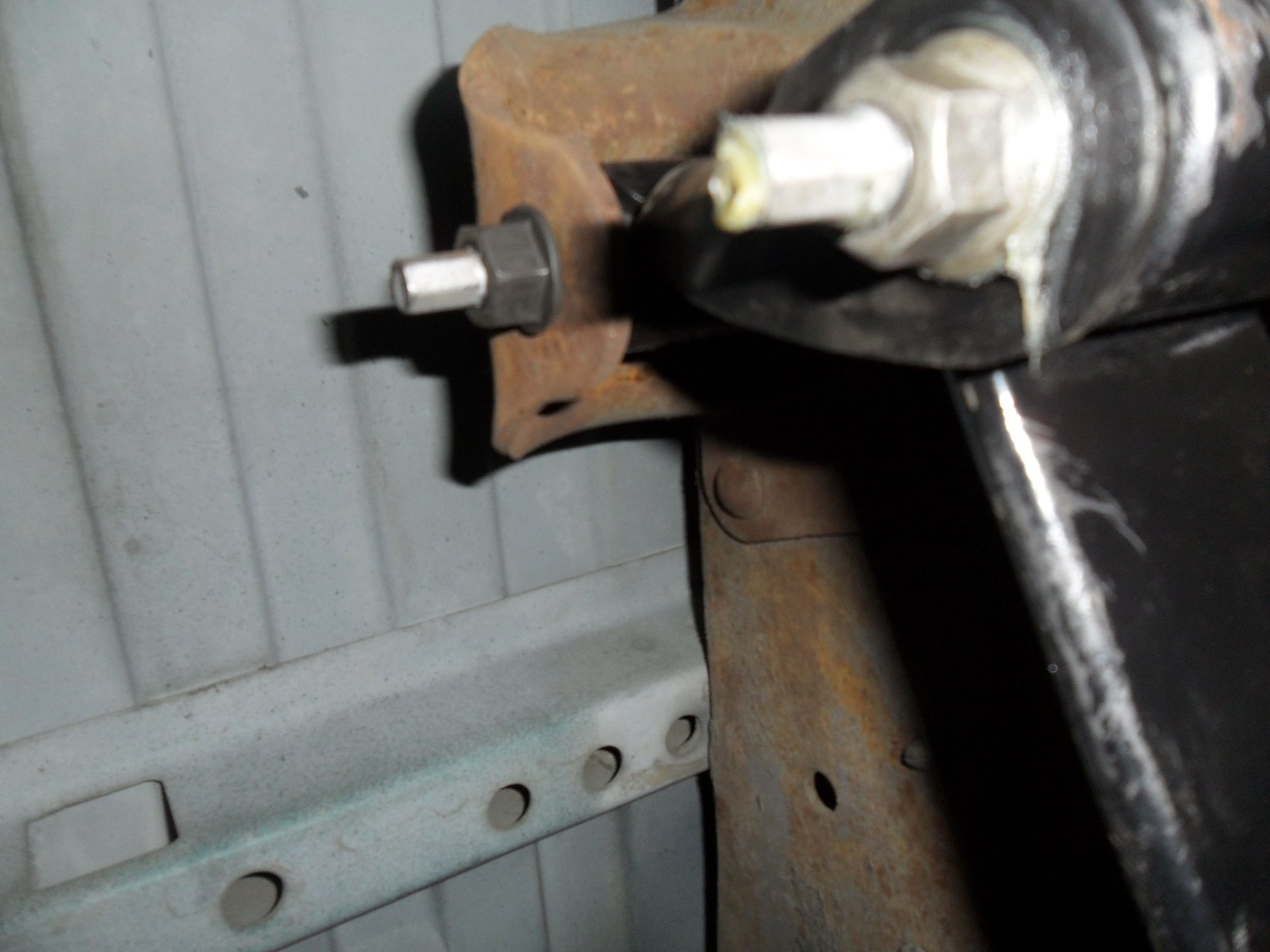

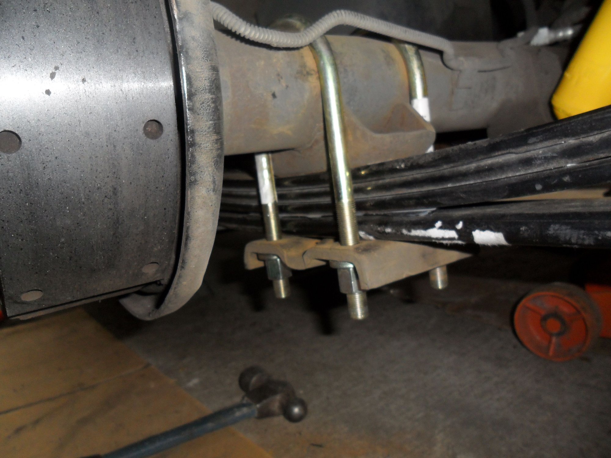

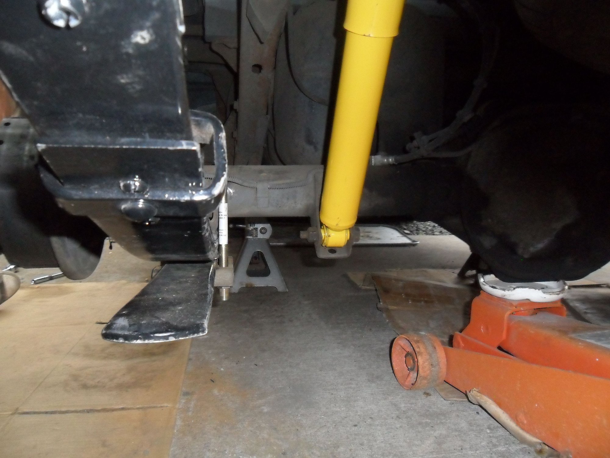

The driver side was mostly easier. I had to unscrew the U bolt nuts all the way until they were loose with a breaker bar. I have some pics. the new bolt for the front from RA is a regular bolt with a lock nut. I ordered 4. Turns out I only needed 2 as the shackles come with 2 bolts. The bolts that came with the shackles are OE style. If anyone knows how to hold the top of the bolt for the top side of the shocks please say so here. You can get the outer one with a normal 1/2 wrench but not the inner.yesterday I wedged it and the nut came off and tightened. This side I only got the outer one off and the inner one loose.There is definitely not a carriage bolt situation but there should be. I have no idea why or how but it tightened up again after I tightened the outer nut and bolt.
I drove it about 10 miles or so and its much different especially cornering.
EDIT- I forgot to mention the OE shackle and leaf bolts have a 21mm head and a 3/4"nut. THE RA bolts and nuts are 3/4 both ends. The top shackle bolt head is inside the frame and I had no thin wall deep sockets so I used a big flat screw driver and wedged it against the flat to hold it while I tightened the nut.
