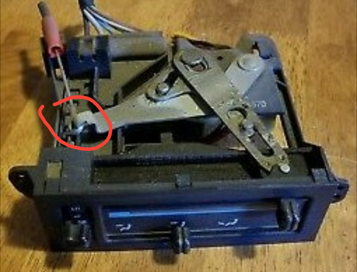

This isn't from my vehicle but an image I found online. The red circled area that's what I was referring to, the end of that cable came off and no matter what I do I can't get it back on. The slide for the temperature only goes about 2/3 ofhe way to the right, thoit goes all the way to the left. Previously I had removed the dash trim, then unscrewed the heater / AC controls and pulled it out as far as I could without disconnecting anything. Try as I might, I can't connect it again.

Here's the instructions on how to remove the brace at the back; after that, it's fairly easy to pivot the head around to reconnect it. It shows the tab at the blend door; the same tab is at the back of the heater control head, and releases the exact same way.

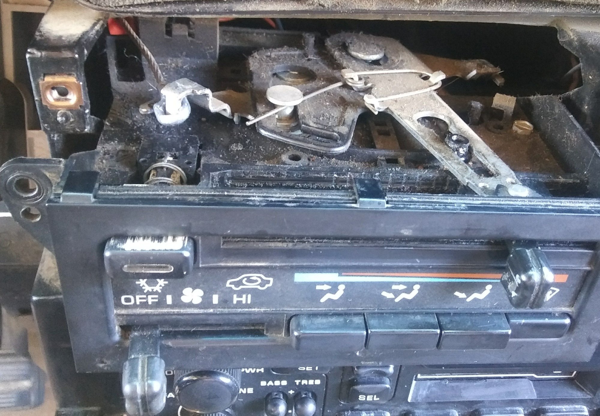

Okay I unscrewed the temperature control unit pulled it out as far as it will go, and finally, after 15 or 20 minutes of effort, I was able to get the loop end of the cable back on to the metal tab where it belongs. But now, I have the opposite problem. Before, I was unable to slide the temperature switch all the way to the right. Now, I'm unable to slide it to the left, at all.

Next step is to follow the instructions in the FSM to adjust the cable at the other end.
THEN you worry about the blend door.
Good note: You only have to remove the lower half dash to rotate the HVAC box out to get to it.
I'd highly, HIGHLY recommend obtaining a copy of the factory service manual before you tackle it, though.
Also, it's not on all the way yet; it goes PAST that 90* bend onto the flat on the top, so that it doesn't pop back off.
