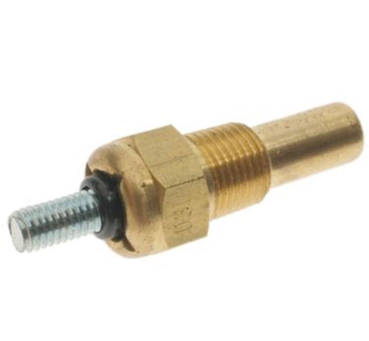

Is there an adapter that I can use for the water temp gauge? The Dakota 3.9 use an 1/8 male npt sensor like the one in the attached picture

I'm sure there is, but without knowing what you are going to, we can't help much.
Is the new one smaller, or larger, than the old one?
If smaller, a bushing should be available at most plumbing supply stores.
If larger ... We gots problems, bossman. The end should be in the water flow; that's kind of hard if you use a larger coupler, an adapter, and a all threads nipple to make it fit.
