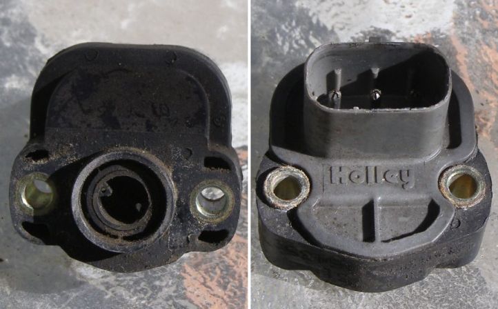

Among the things which came with the van were some sensors, one clearly an O2 sensor, another was labelled as a MAP sensor and it looks like those pictured in advertisements for MAP sensors. The odd man out is this one, which isn't new like the others:
It appears to me to be a throttle position sensor, but branded 'Holley', does it belong on this van?

That's still to be established...
I have to get it on the road (ie. complianced and registered) before I start working on that, my nephew will be able to diagnose most of the issues, I'm sure. But just working out what was going on before I bought it is an issue at hand, and establishing what that Holley component is might lead me to an answer on that.
most all TPSs work the same when it comes ot the 5V bus...
if it fits right and reads 100% WOT technically it should be fine...now in CANBus you have to have the exact one AFAIK
but you have OBD1 - a new Ebay special is like $20 - try one for the heck of it
