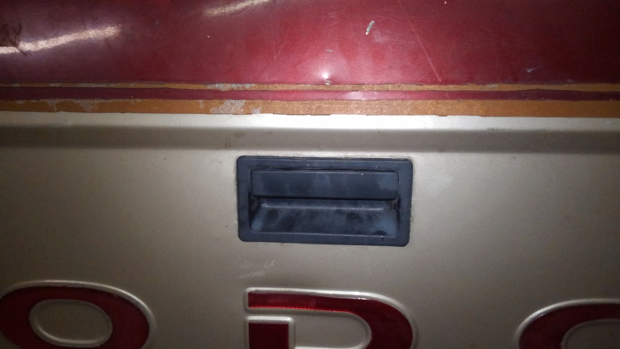

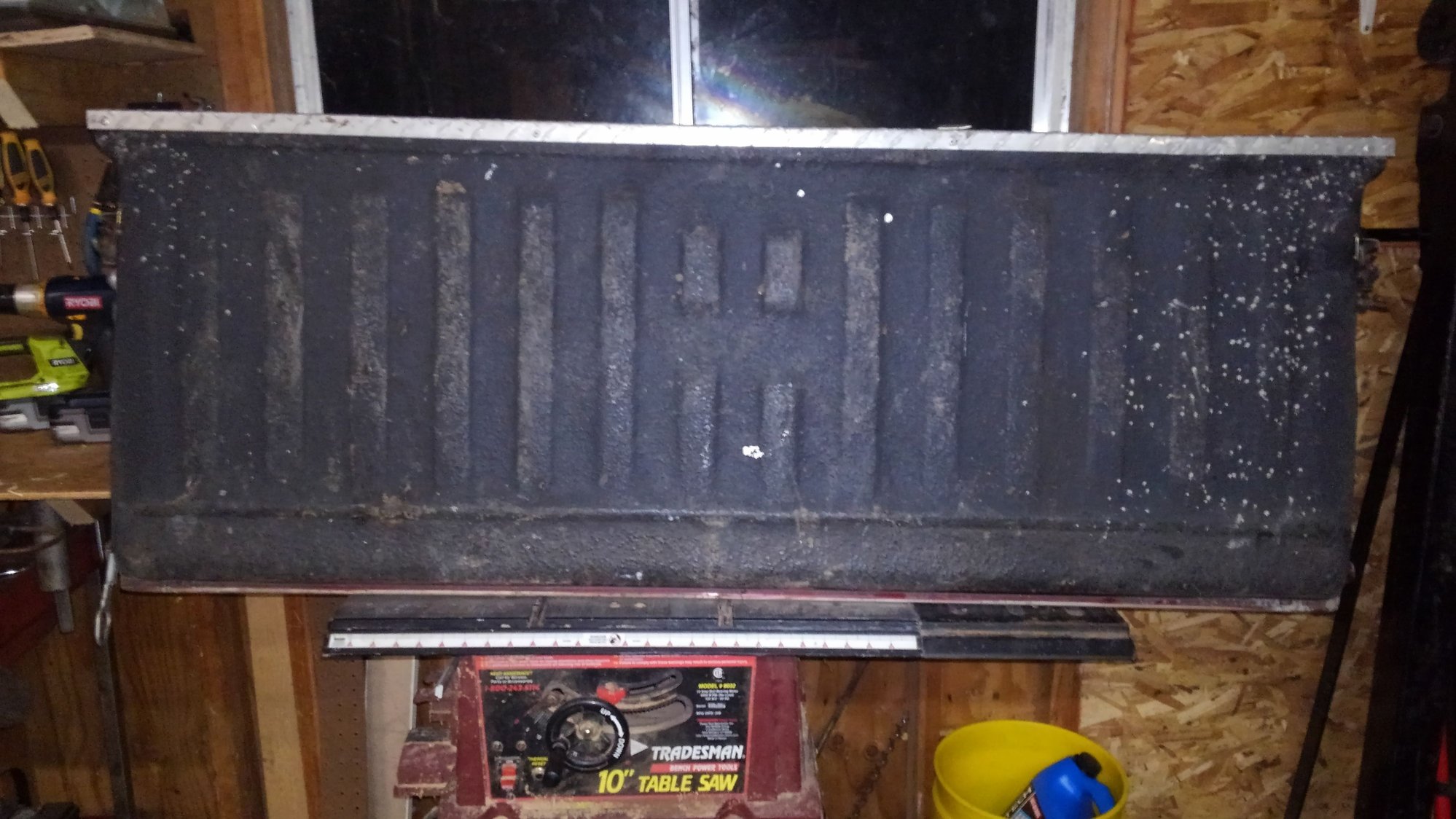

this is the back of the tailgate
Close view next.
Front view and back with closeup to finish.
the handle is behind the two short bars up top .
I am not sure how to get in this thing.
Steve

You will need to get a wire wheel on a grinder to remove the coating to get at the panel..
Old Nov 19, 2018 | 11:58 PM
Azboyinmi's Avatar
Azboyinmi
Joined: Mar 2018
Posts: 335
From: Michigan
Yep someone rhino lined your access panel. If you grind off all your bedliner and decide to put a fresh bedliner on, make sure you coat the tailgate and panel separately so you never have this problem again

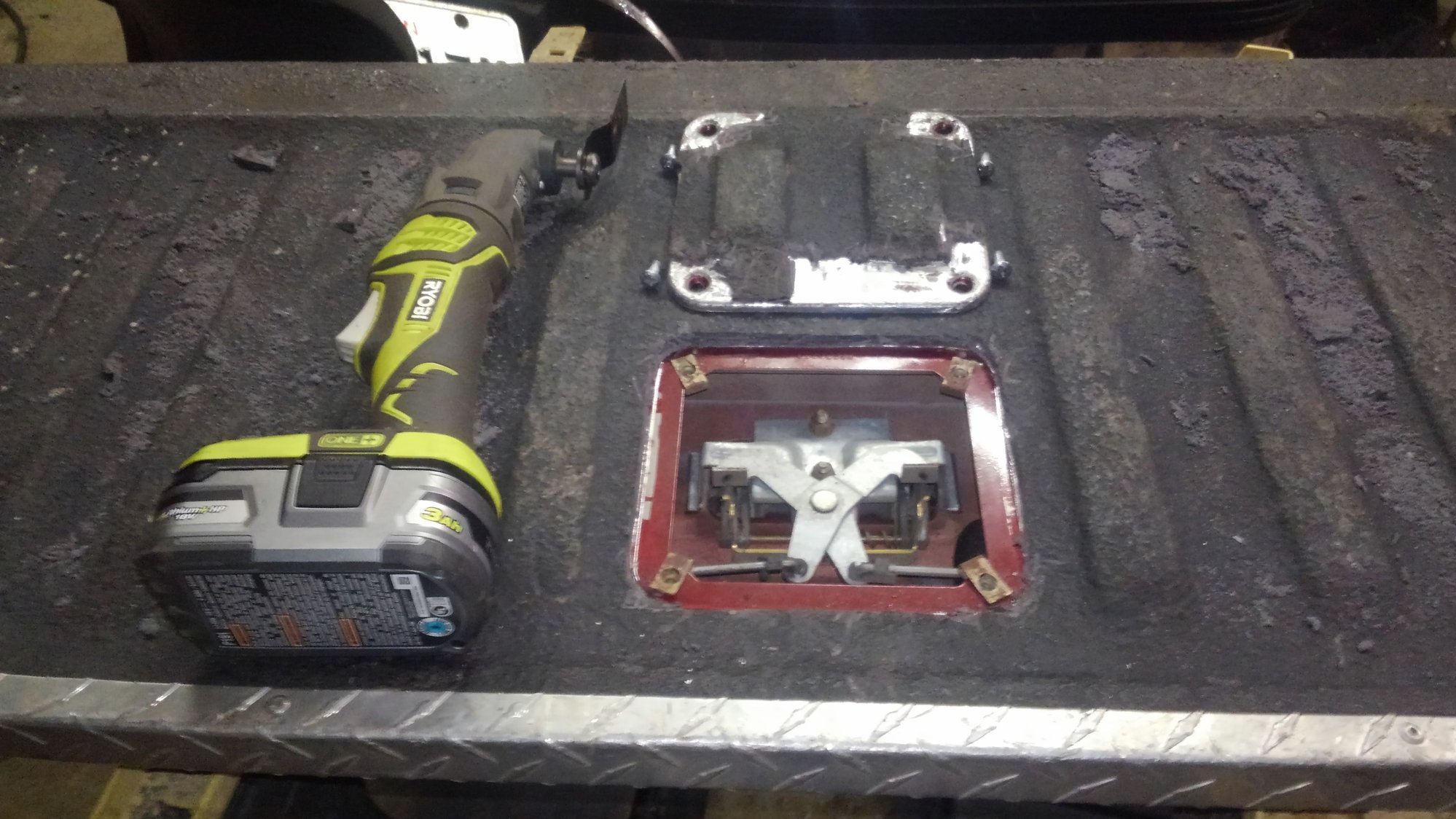

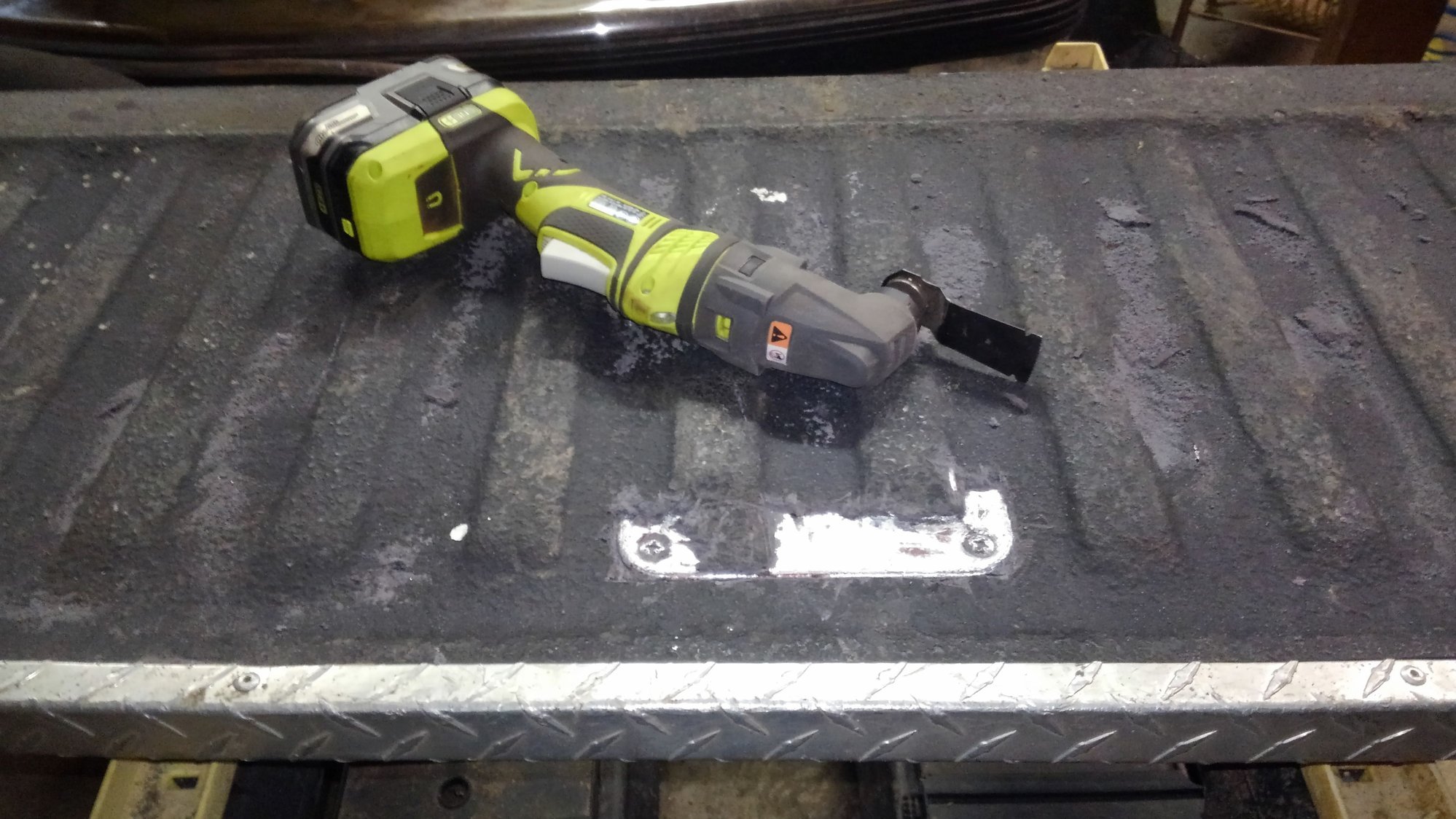

The site won't let me post the pictures, but I got the cover off after about an hour of scraping with my multi-tool. Then about 10 minutes to fix it and another 10 for reassembly. The multi-tool made some very precise cuts so I just need to buff the coating off the panel, paint it and spray some rhino or undercoating on to protect it.
I have spent 3 hours trying to load the pictures. The cuts are very impressive (at least to me).

Let's try to get some pictures up
The first was after about 20 minutes at 2:00 AM. The second is once I found all the screws. The last is success at last.
The rest of the job was a piece of cake.
After the holidays I plan to strip ALL the stuff from the panel and paint then coat the thing. The screws will never see more than a coat of paint on the heads.
