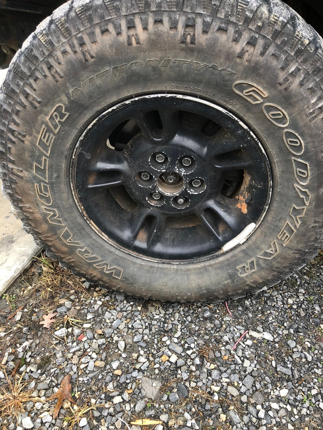

Hey was needing some help figuring out what the rim size is so I can but new tires but I don’t really know what it is actually I know as of right now it has 30.5x10.5R15 tires on it but I am needing to know true rim size. As I’m certain the rims are bigger than 15’s and I know you can mount a size smaller rim size if needed to do so . is there any way of figuring this out without popping the bead and measuring it with string and measuring the string out . Hopefully I’m making sense.

They are 15" wheels. 15" x 8" I think.

If the tire is a 15" tire, the true rim size is a 15" diameter.
As to width - they do make calipers to measure that; shucks, they're supposed to measure that and key that into the spin balancers! Ask the local tire shop to measure for you.
But as tbugden said, 15" and probably 8" wide with those tires on it.

Ok thanks for yalls help. my reason for asking is because my dad has a Durango and his rims are 16’s and they look exactly like the ones I have I didn’t know if there were any markings or something to indicate the size of the rims but I’ll be going with what the tire says. P.s any suggestions on some new shoes for the truck will be appreciated

Those wheels were never made in 16", the 16" that resembles these is slighty different. The 16" come in 7 & 8" widths but AFAIK the 15" you have all come in 8" only.

Those rims are 15inch rim , 8inches wide, bolt pattern 6x4.5. Dakotas can fit anywhere from 205/70r15s to 235/75r15 tires stock and lifted can fit 31 10.5 15 so you have a decent selection to match your needs
On the other aluminum/alloy rims the width is really all that changes, they can usually fit 7-9 inch wide rims/tires
