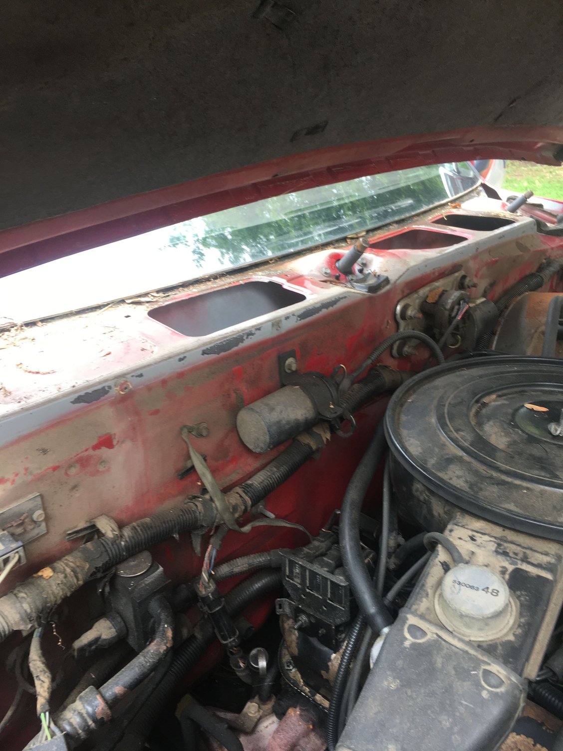

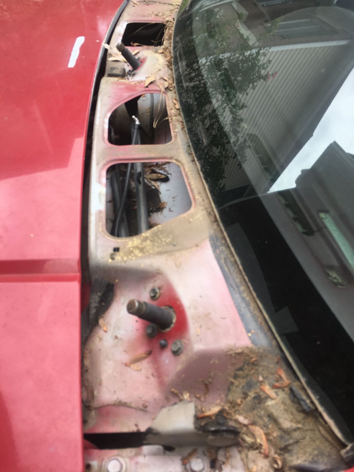

Finally getting around to this. I have the cowl off but I’m confused as to where “down to the fender” would be.
Originally Posted by RalphP
1990 still has the ram air vent; I'd pull the cowl cover and clean out all the leaves that have probably collected in the cowl, including down into the fender, to clean out the ram vent.
That's one possible point; takes enough water coming in to back up into the ram vent when the drain is partially plugged with leaves.
Your other possible from where I'm sitting would be bad door gaskets; either door frame to door or window runs.
RwP

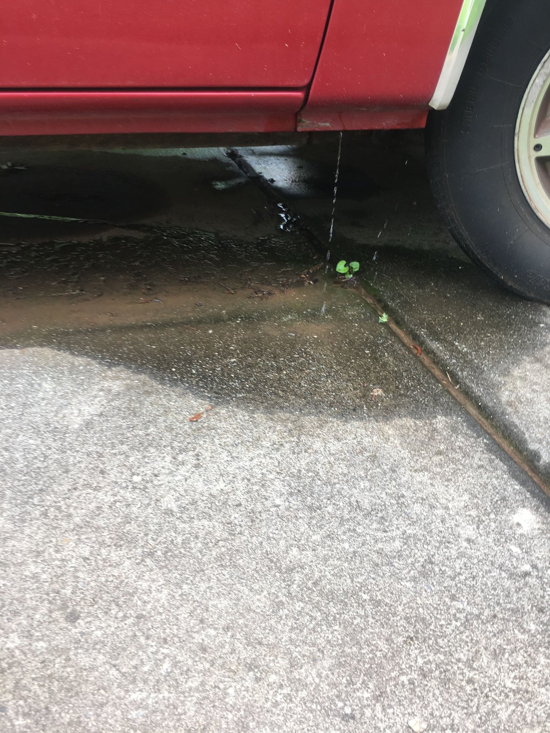

Here’s what I got after dumping three gallons of water directly into the openings under the windshield. No noticeable pooling in the floorboard like I get after a storm.
Not "down to", "down INTO".
Go to the outside edge with a fish rod of some kind (they actually sell flexible cleaning brushes for things like cleaning lint from exhaust hoses from dryers), and follow the path down.
RwP
Ok, so down into the space behind the front wheel?
Yep.
OTOH - if you ran the water in fast enough, and for long enough, and it didn't run into the ram, that's not it.
That's just one possible source; not the ONLY source, mind you!
RwP
