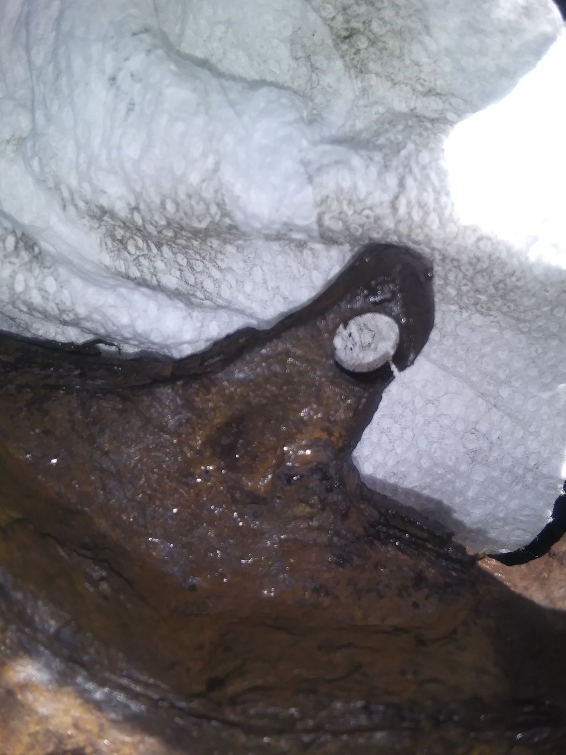

The tab the caliper guide pin goes into broke.
The tab for the caliper guide pin broke. Can it be welded? Or just replace it?
Old Jul 21, 2019 | 08:20 AM
Posts: 87,415
Likes: 4,214
Replace it.

The knuckle assembly (steering arm, caliper bracket, and spindle) change three or four times during the 1st generation; but look, car-part.com does list several spindles (which include all three.)
For a 1995, the knuckle assembly for rear wheel anti lock brakes part numbers are 4447 560-1 ; for 4 wheel ABS they are 5203 8062-3 . ( Second number is driver's side, first is passenger - so for you, it's either 4447561 or 52038063 .)
That number is good 1991-1996 from the two parts manuals in the index.
Assembly changed from a different number in 1990; probably with the addition of the ABS and with the addition of the 6 lug wheel bearing.
So for you, 1991-1996, but match the ABS status of your truck.
Again, car-part.com shows several knuckle assemblies, some down at $40, across the US; shipping will be extra, but you can call the yard. (Shucks, that yard MIGHT be in your back yard; I have NO idea where you are!)
I'll add that if it's THAT badly rusted ... I'd be taking a hard look at the rest of the suspension, and considering dumping it for a new to me truck. That's horribly rotted out.
