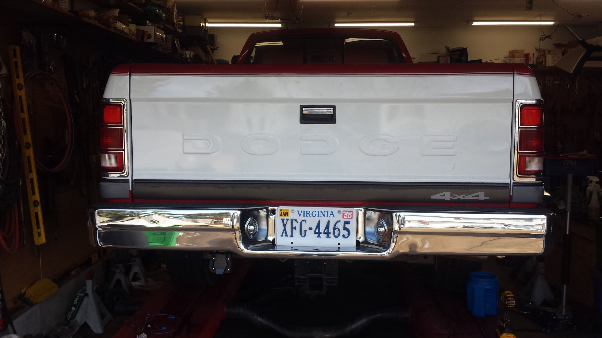

I think I have the same one and my experiences echo yours. I've always liked Curt hitches. Got one on the Dak my Honda Fit and my old Accord.
