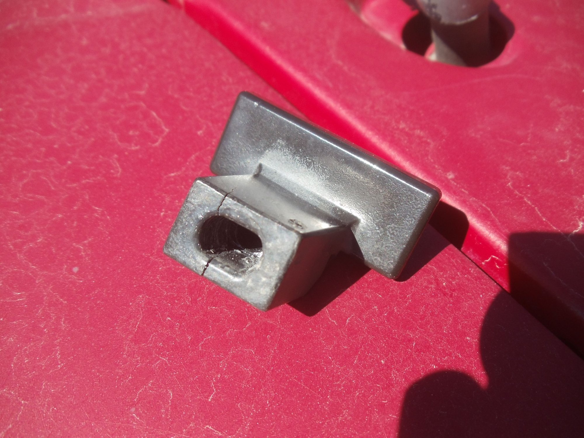

I will never get over how manufacturer's use plastic for critical parts. This is the second plastic parking brake handle that split on me and came flying off. Is there a better solution? Thank you.

I recently replaced cables, cleaned and lubricated all the mechanisms, ratcheting teeth, cables, etc. Not only that, I am pretty much a 98 pound weakling. With a 5-speed and 285,000 miles on the odometer, I don't think it is my fault but more likely just plastic giving way over time.

Yep, mine went too. The inside of the plastic handle is threaded and when the rear section cracks like that it loosens the threadgrip. After that, it's only a matter of time before it pops off.
I just welded a flanged nut to a piece of 1/4" bar stock and threaded it onto the rod. It won't break ever! Now I'm wondering how long before the plastic hood release handle comes flying off!

Fantastic, now that's the answer I have been looking for, thank you.
In the above photo it looks like the flanged nut is welded offset (not centered on the bar stock) and it also looks huge. Am I seeing things correctly?
