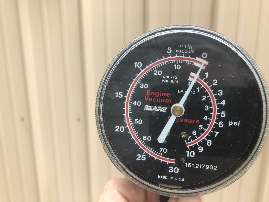

Hook a vacuum gauge to the intake somewhere and see what your engine is pulling.
15" hg on the MityVac at the PCV hose It was vibrating a lot back and forth but not as far as the next line wither way. The Mity Vac manual says it should be steady.
Edit- When I revved it the needle would drop below 10 then jump up to over 20? Oh yea stuck the vacuum up the tail pipe no bubbles around the exhaust manifold or the Y connectors where I could see them. Used dish soap and water in spray bottle.

Vacuum at idle is low. You have a leak somewhere. Other behavior is normal.

15 is a bit low. I like to see 17-20 at idle. Part of that may be the type of gauge you used. I have a dedicated gauge just for engines. I would next test a vacuum line to the distributor or throttle body. You might need to add a tee to do this. The flutter is troublesome. It may be late timing from a worn timing chain for the low vacuum . The flutter though, can be a bunch of things. A sticky or burnt valve can do this.
How many miles on the engine?

I have a similar tool to bleed brakes and actuate solenoids on older vacuum controlled ventilation systems. I use this vacuum gauge as the large dial will let you see little flutters when tuning an engine for the track. You may not have a line to the distributor. This was built about the time they were going away.
Now, this is very important. How many miles on the engine. More, or less, than 120,000 miles? Issues with a low mile engine may look the same as a high mile engine but the causes can be different. Have you checked for timing chain stretch?

Felt better so I put the vac on the T coming off the ball on the firewall. Got a solid steady 17.5 or 18"hg I think it had a tighter connection than what it had on the PCV hose off the intake.
