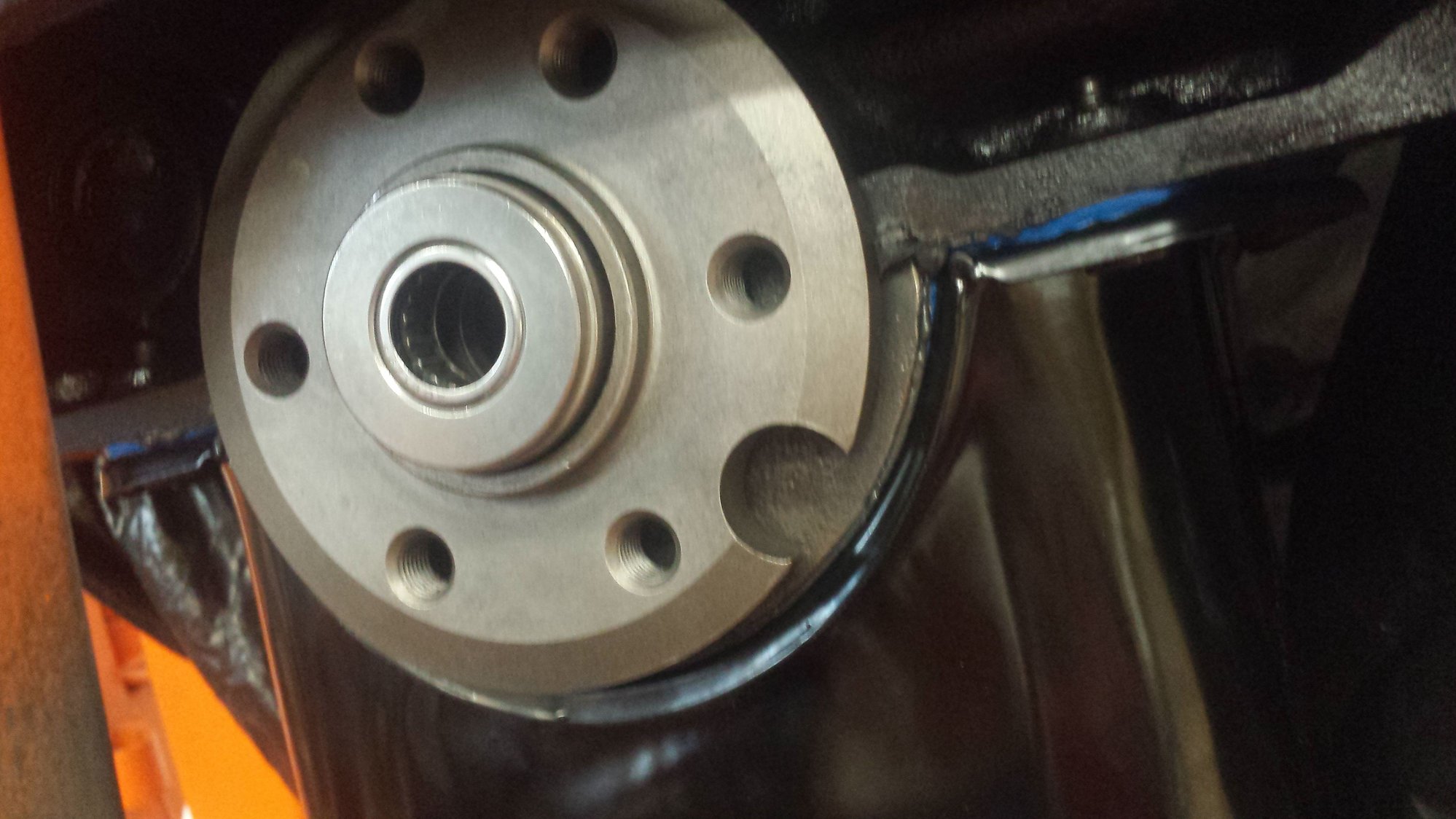

Im going to tell you what I think, but Im not 100 percent sure.
I believe the cranks are the same. In fact, looking at rockauto.com they only show one for the 94 3.9 dakota. manual or automatic.
I believe in older cars it made a difference due to how the pilot bearing mounted.
In older mopars, it was deep in the crank, and sometimes was not drilled deep enough or machined for the bearing or bushing.
In magnums, the outer section that would center the torque converter is used for the pilot bearing and its housing.
Below are two pictures that may make it more clear.
FWIW I have heard that when using the magnum in a older mopar, you can use the new style bearing and shorten the input shaft. So I heard.
