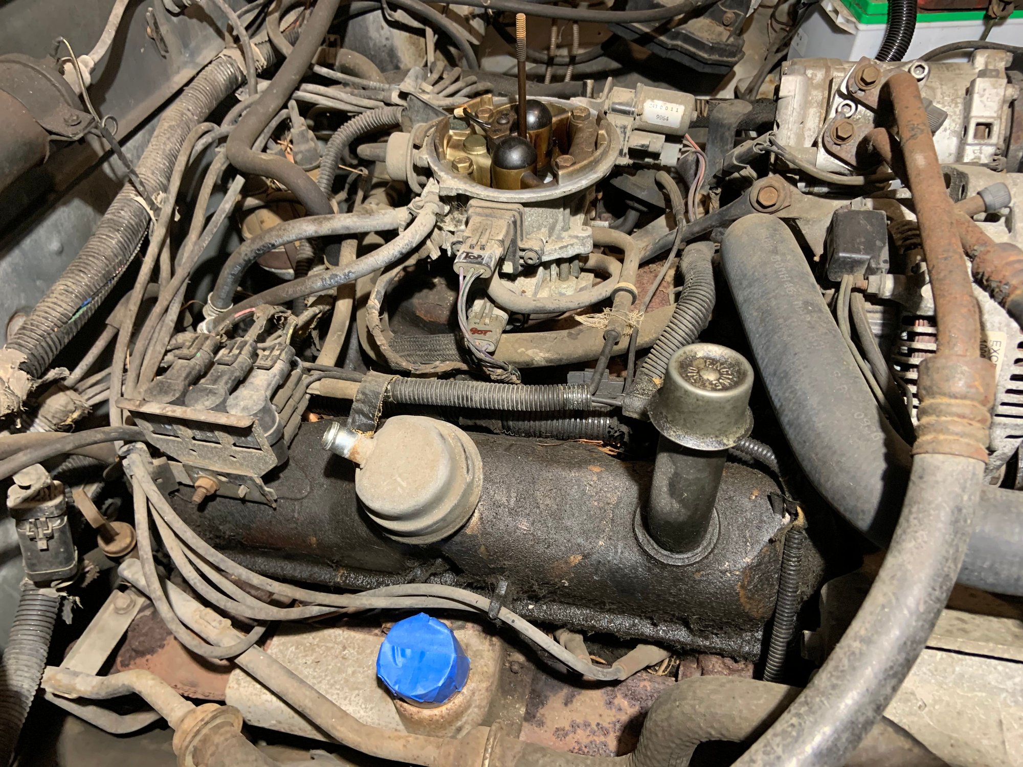

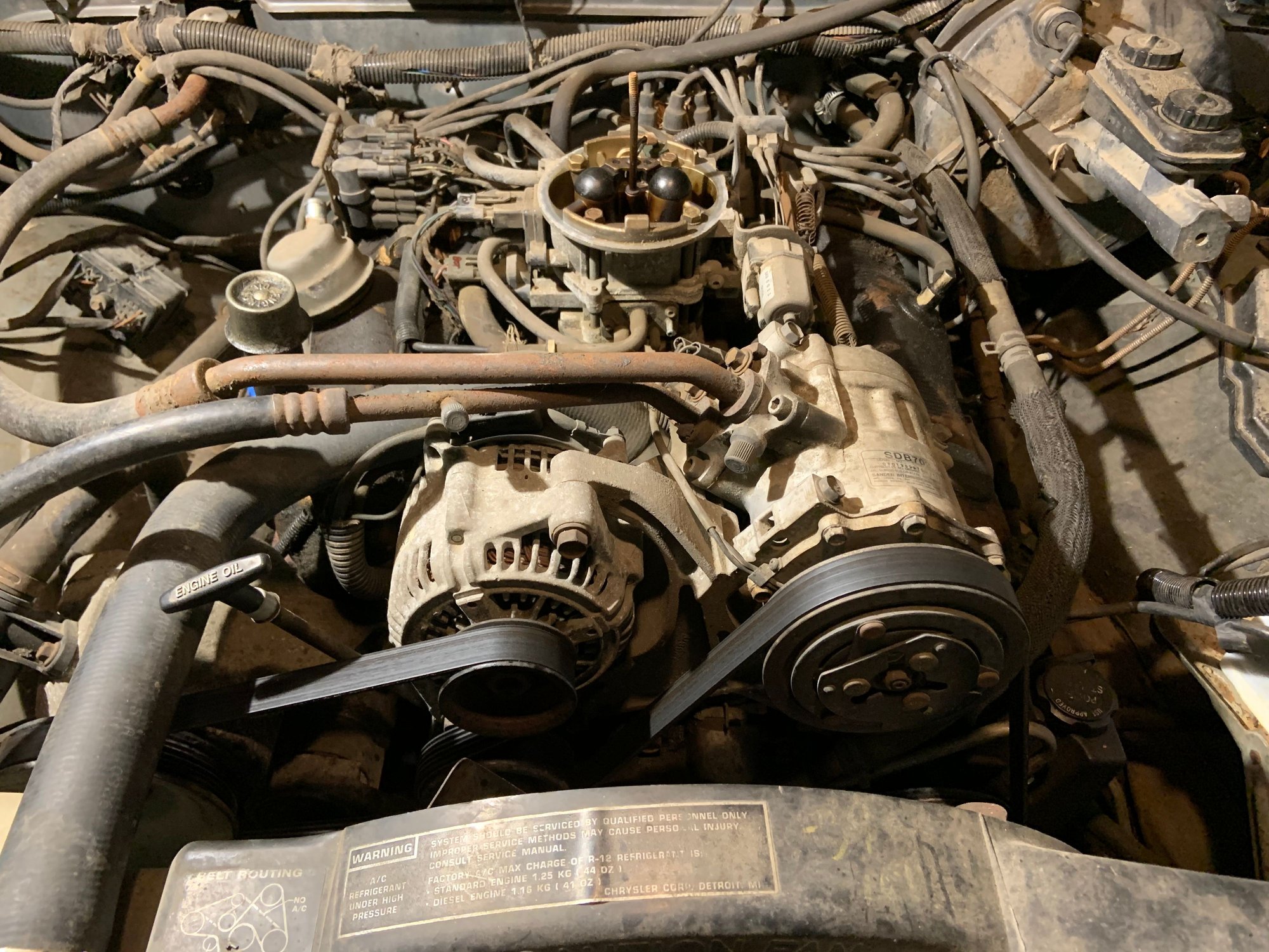

Well, I have a lot to learn. Here are pics of my engine with the air cleaner out of the way. Badges on the car say EFI. When I lookup the VIN it does say 1991. I think I have a throttle body. I hope I don't need new heads!

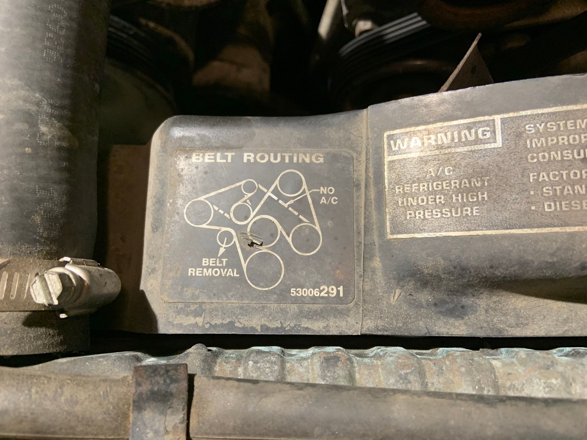

I think I want to lose the AC compressor and associated hoses to make it easy to work on... I highly doubt the AC works and it's just added weight and complication. The serpentine sticker shows you how to route the belt for no AC!
Looks like plug wires need to come out first and then the fun begins!

It's not a Magnum. It's the LA 5.2/318.
This complicates matters a bit - it's harder to find LA heads now.
But they're findable.
ARP does sell a fastener set for the LA motor; I'd grab that for the re-assembly; the ARP fasteners are arguably far superior to the "torque to yield" factory fasteners, and they're reusable.
Ignore the heads I linked to; those were for Magnums. Yours is not a Magnum.

Just so you're aware, more often than not, when cars don't have AC, they usually require a different-size serpentine belt. I just looked on RockAuto, and they have a different belt listing for a 91 with AC vs no AC.
