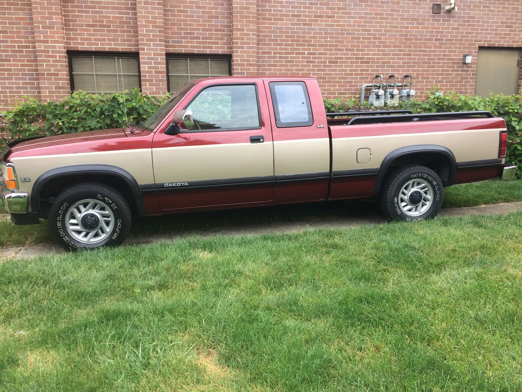

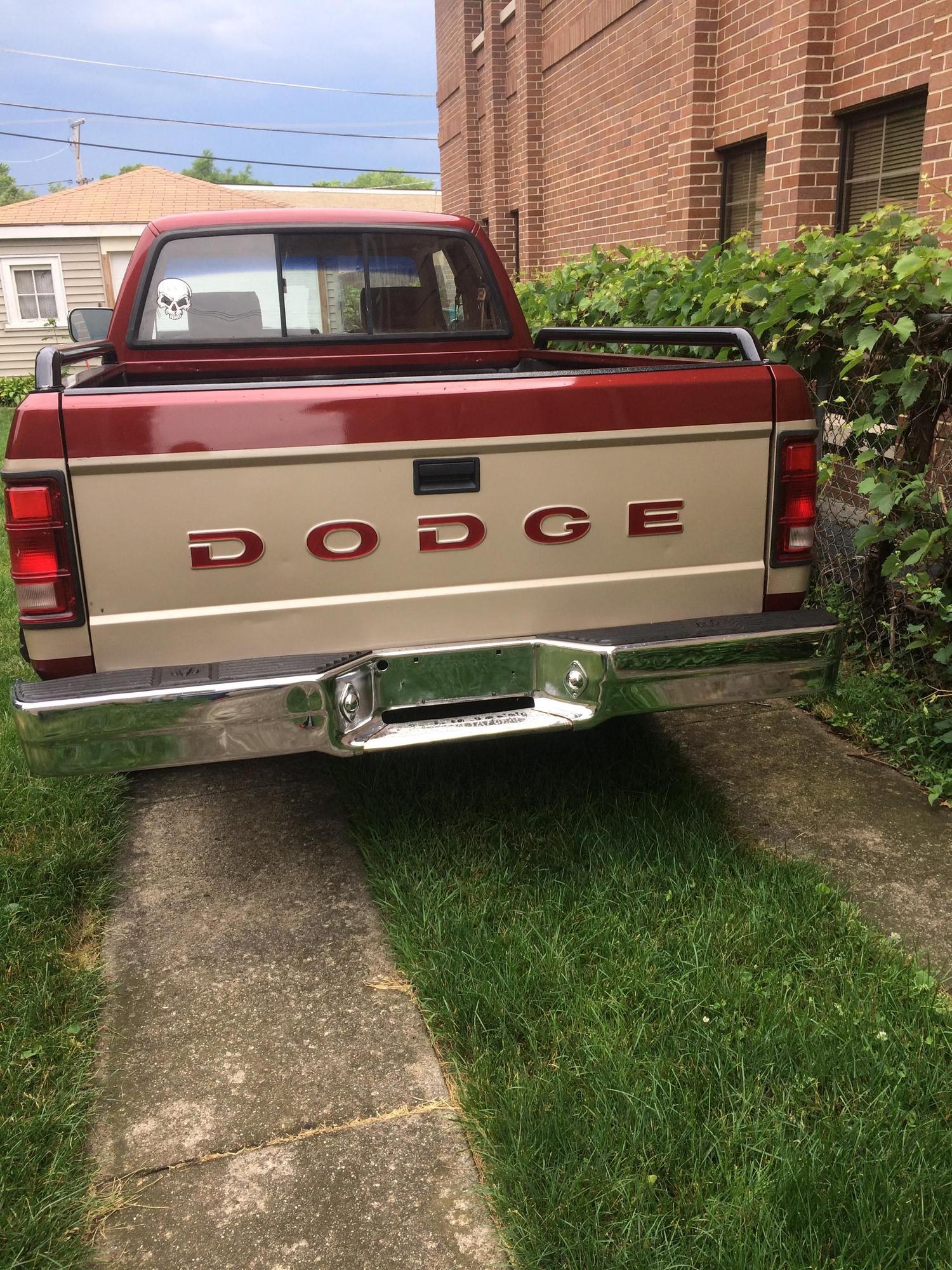

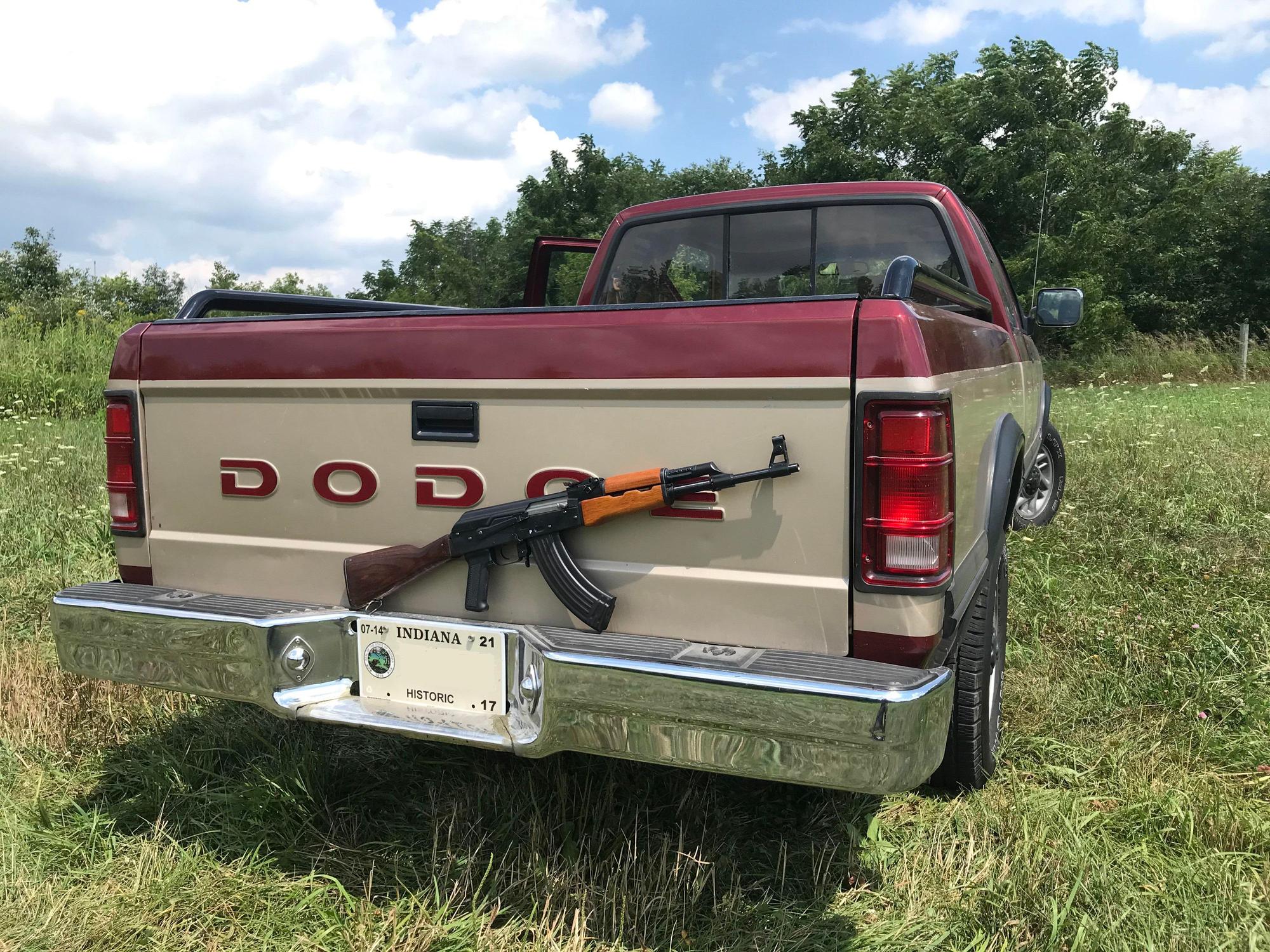

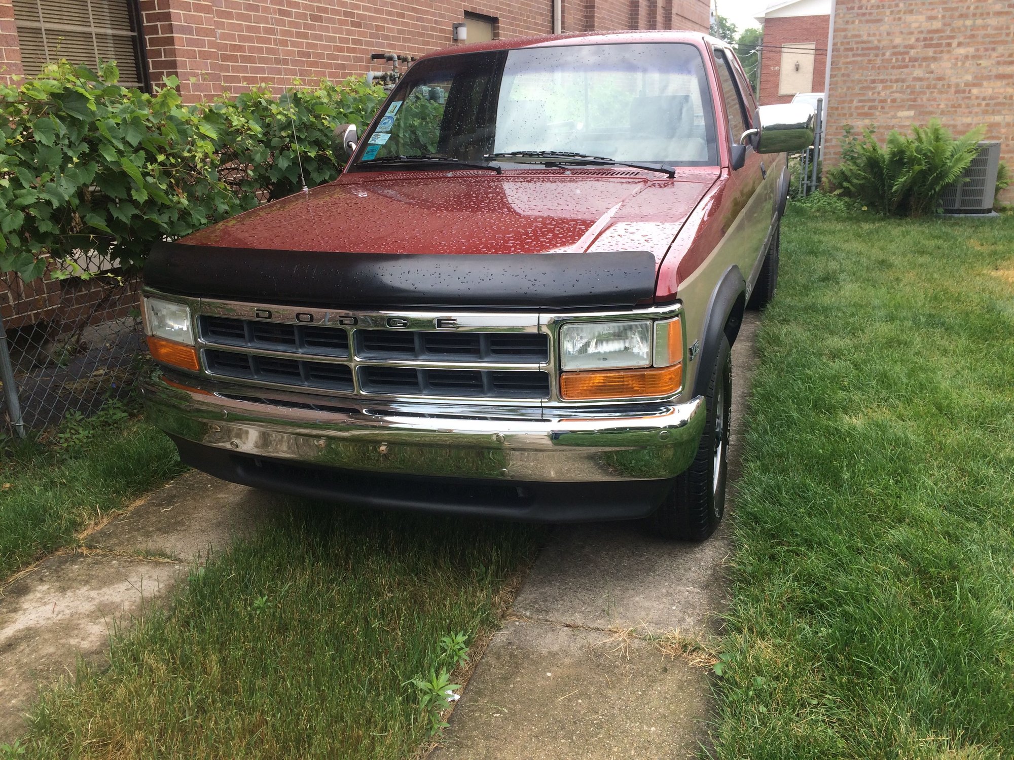

As promised, here are the pics of my baby.

Was the AK a factory option?
For it's age, that truck is in EXCELLENT condition.

Appreciate it! My pops is the one who actually found it, we've known the owner for quite a long time though, super nice old man who was always old since I was a little kid hehe, this beauty was sitting covered up in a garage down the block for about 13 years and we didn't even know :P, he bought it brand new in 92, and even had it ziebart rust proofed when it was new too! I almost cried when my dad told me how much he got it from him for..... 2k. My dad is adamant that the old mans son rolled the miles back on it or something and cant believe it because the interior is a bit beat up and the steering wheel is super worn down. but when I looked up the vin and registration ETC. the mileage matched up, just a little bit under what was on the dash, about 44900 and last registered in about 08 so I really doubt it.
I plan on installing a tow hitch on this since it doesn't have one at the moment. anyone got a link to one that will work with this model?
as for the MAK90 that was an aftermarket upgrade, you'll have to google my username to find out where that one came from
