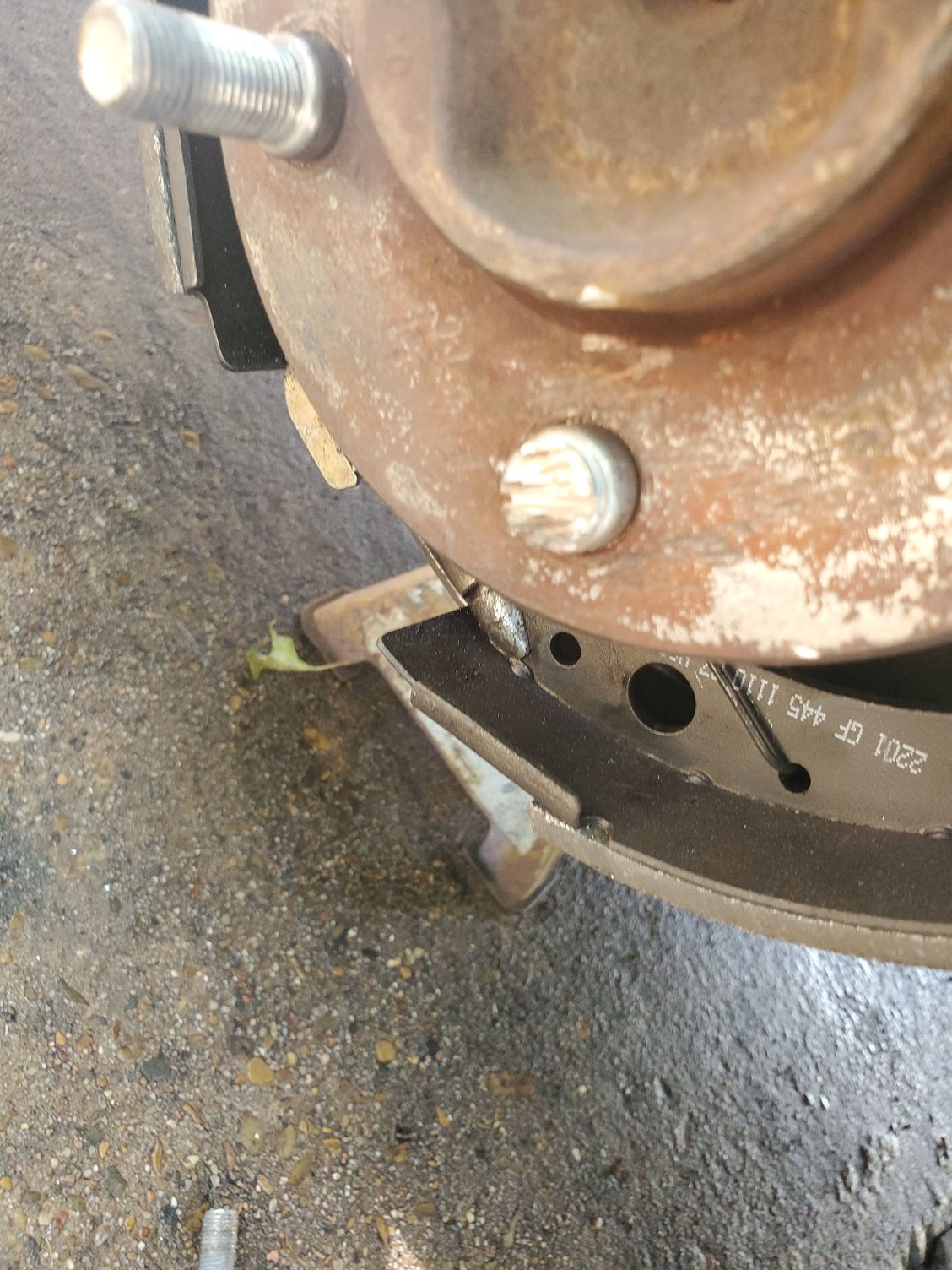

Here are a few pics of my replacing a stripped wheel stud on the back of my Dakota while the axle's installed.
Arrow points to stripped wheel stud
Cut off most of the stud.
Cut into stud for chisel on hammer drill set to hammer. Ended up cross cutting and using the point chisel.
New stud installed.
I used a 5/8" nut (should have been 11/16" or 3/4", but I couldn't find any), a pair of thick 3/4" washers, a 1/2" washer, and a 1/2-20 Grade 8 nut.
The stud came out and I was able to install the new one with the axle just like that.

This beats having 3 studs holding the wheel on (I had already replaced the twisted off one; I may go back and do the others later.)
