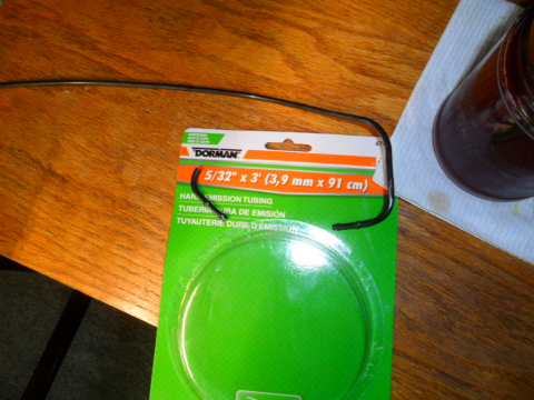

Just broke one of those lines all tucked in there so tightly on top of the EGR. Any idea what the OD size of that tiny thing is? I figure I can fix it with a 6 inch rubber vac hose if I can find out what the size is. I've never seen something this small. Looks to be less than 1/8. I imagine its metric.

Dorman has it. I looked it up and the part I thought fit, #47417 was too small! But the AZ I went to had #47418 on the shelf and it was the right size. See pic. Sorry for cutting off the part number. I also got a foot of 5/32 window washer hose. It would work with a clamp over a smooth hose. It slides on but wouldn't hold vacuum w/o a clamp.
I put this in just like the OE line. The only difference being the Dorman line doesn't have the bulbs the OE line has.
