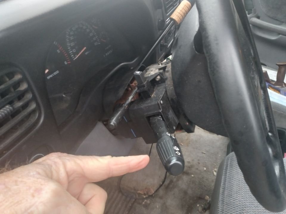

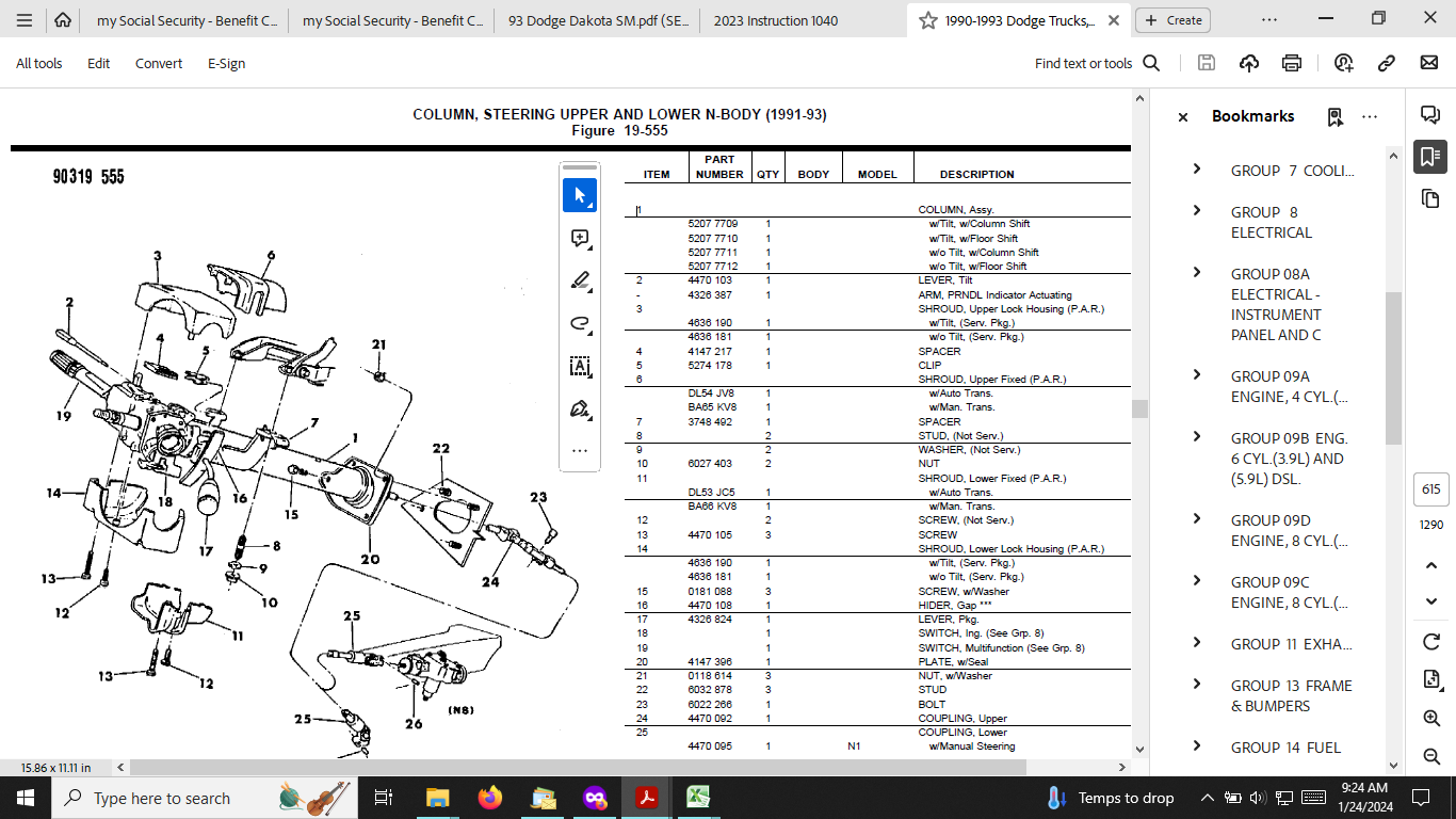

Originally Posted by bronze
Would this be the switch you're talking about (see #18/#19)?
#19 is the problem child. This puppy right here.
I found the hard way, the cover that is missing will NOT use a 1998 cover. It has to be a 1996. My 1997 Dakota is a chimera of different years. I'm having issues with my wipers at times. The switch does a LOT of things and eventually wears out.

So you're talking about the switch at the outside end of the stem...where you turn the wipers on and off. The parts manual says see Group 8. Just gotta figure out where to find Group 8 in the manual.
So I'll be checking the ground first then as you suggest hit the brights next time the headlights go out to see what happens. What is the best way to test that switch if need be? Continuity?
