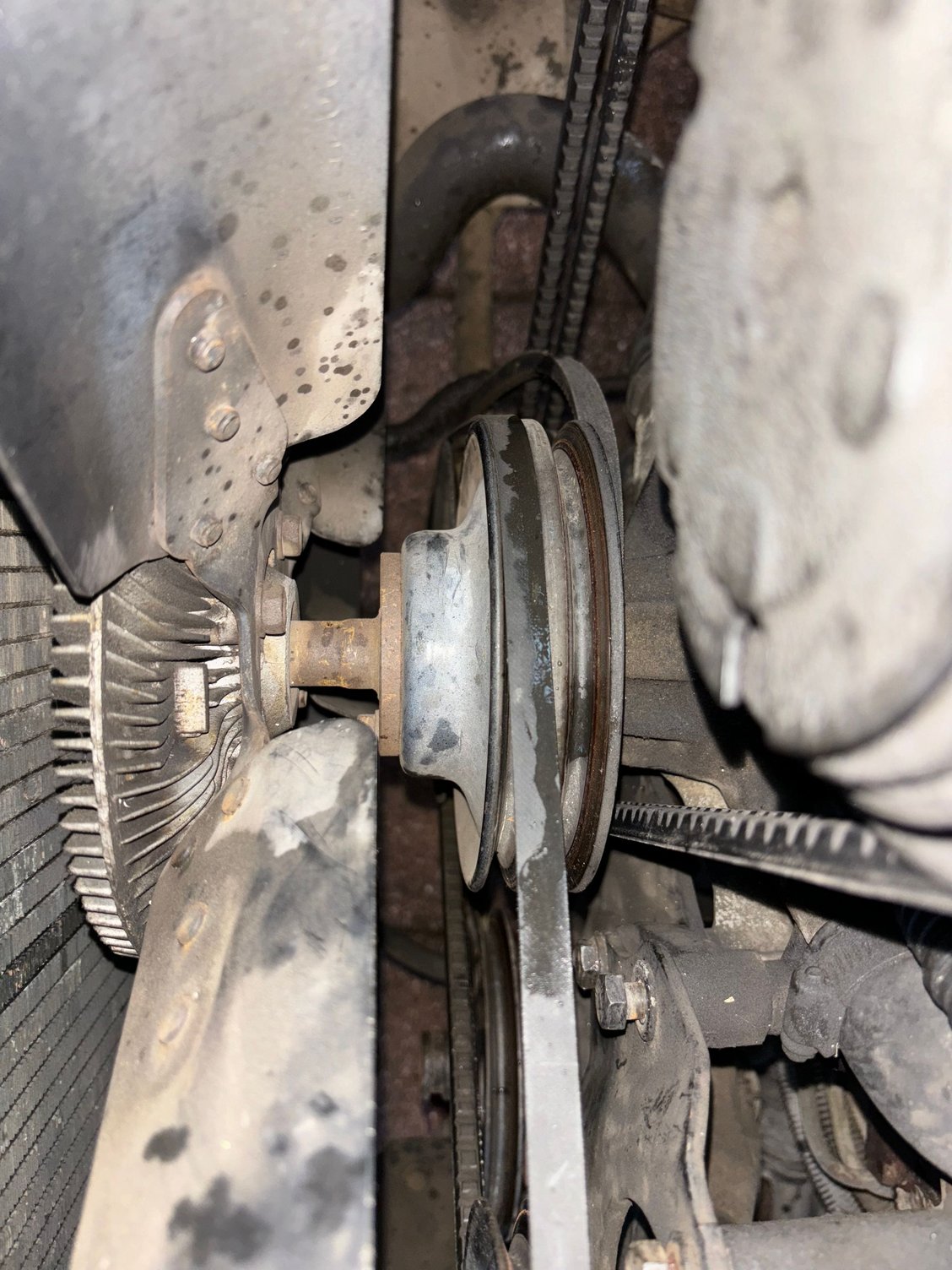

Hey I loaned this fan removal tool from oriellys. I think it called fan clutch removal wrench. It said it can be used on a dodge 3.9 v6 but I couldn’t figure out how it works. So, what I’m getting here is, how do I take the radiator fan off this 1988 dodge Dakota 3.9 v6. I’ll upload a picture of how it looks too.

That's probably for the later ones, You have the old bolt on stye. Looks like you have one bolt holding the fan on. After removing you may have to wiggle the fan to get it off.

You don't show the tool. In the bottom picture I can see one bolt hiding behind the fan blade. Looks like you took the other 3 out or they are hidden by the angle of the camera.
Look at this page scroll down to see the fan clutches so you can get an idea of how it is bolted on. https://www.carid.com/1988-dodge-dakota-radiator-fans/
