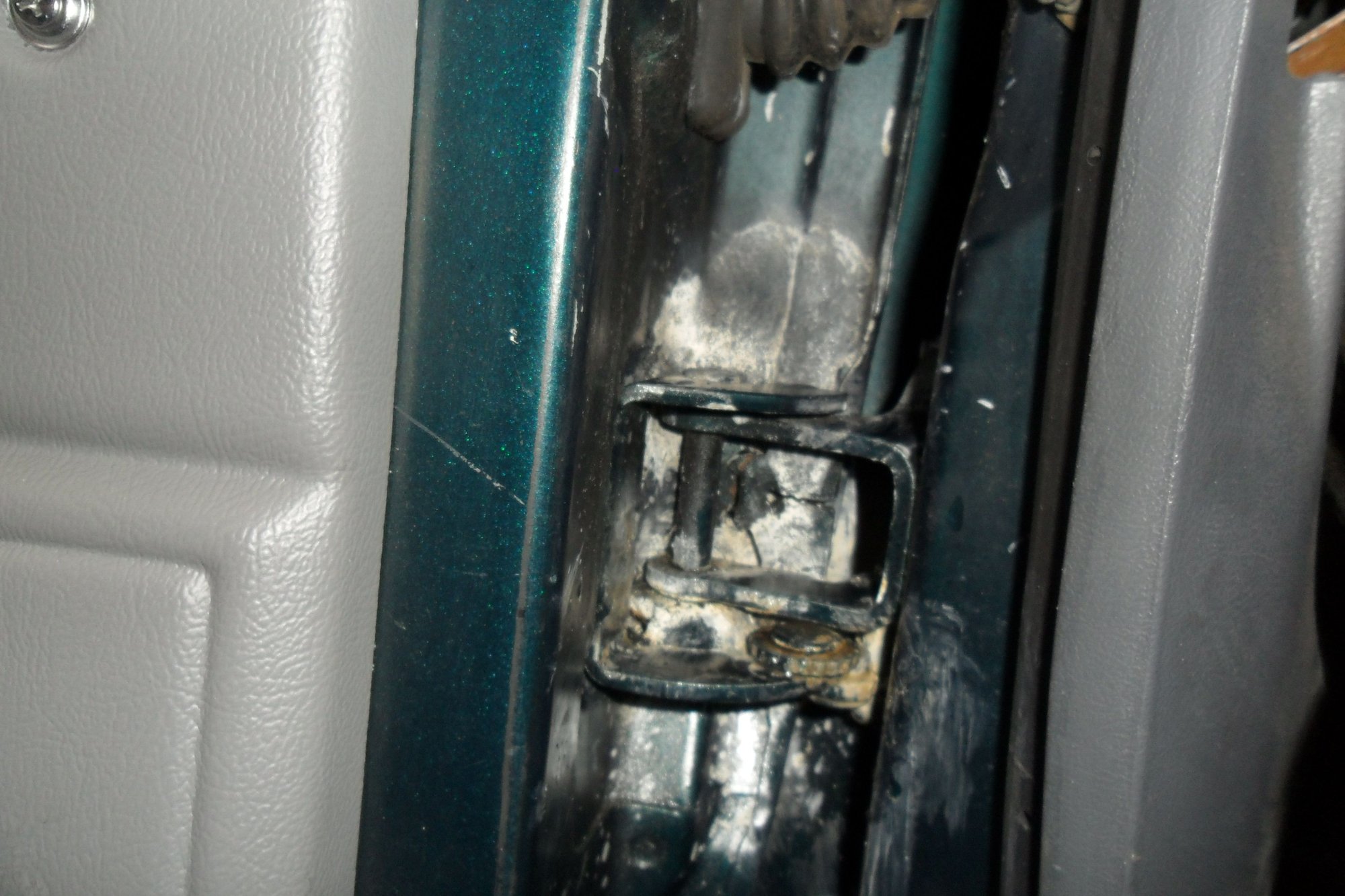

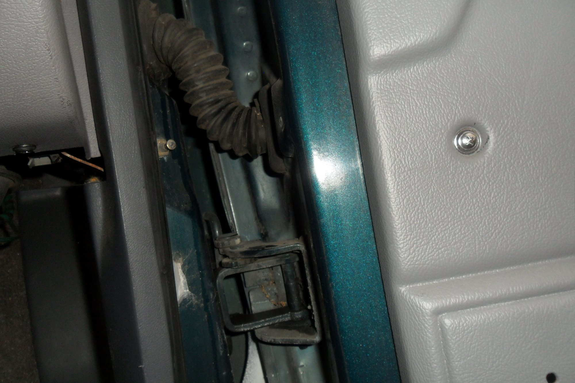

I have a conundrum. The passenger btm hinge looks different from the driver btm hinge. Maybe I'm just old. I did find this video by LMC I hope might work. And there was a guy on there Brody Holtz who had the same issue with a 96 with the new body style on his passenger door. He removed a lot of the body to get to take out the whole door and hinge to take it in to get welded. And I am now unsure the pins I ordered will work. Let me know if this looks right for the 1994 Sport.Here's that LMC vid if you want to see a guy do the pins on a bench.

You can really see the driver side hinge has dipped into the body of the door compared to the passenger side. I think I will have to remove the whole door and hinge.

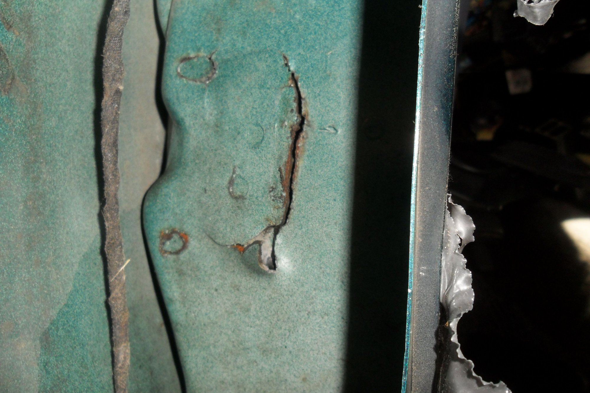

I opened the interior panel and removed the speaker. This is what it looks like from inside. I hammered it out as much as possible. Had to push the door out to get it to go back into position and then it went right back on closing. I can probably weld it but I have to take the door off.
