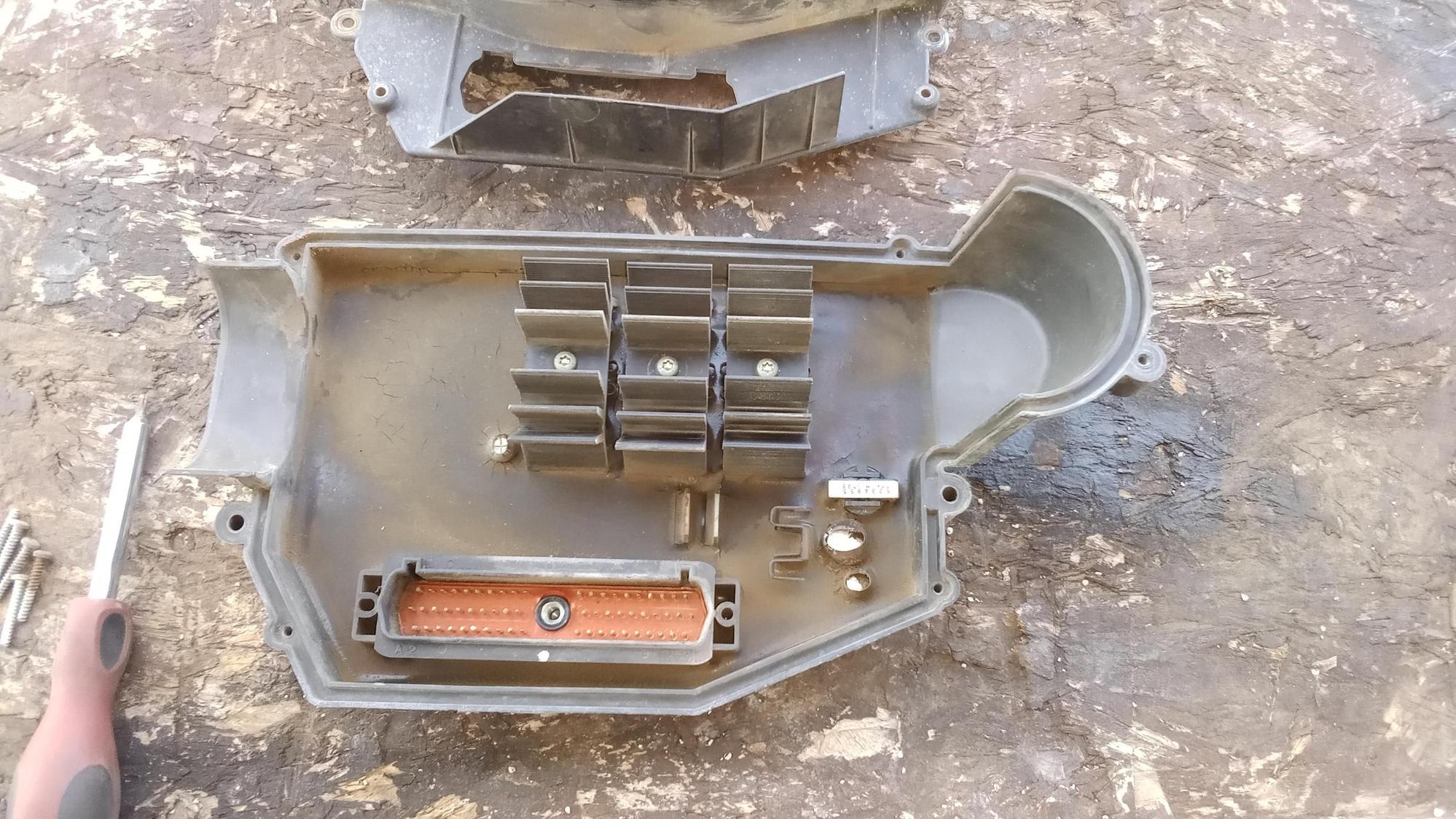

Just my opinion and have been wrong before ... 1993 had some very basic things the computer controlled.
The 1993 - 1995 computers were very basic ... but it was a time of advancement.
It is very possible that a 1993 ECM will not work in a 1995 ... but a 1995 will work in a 1993.
I also think that for the price, would probably be worth the price of admission to try it.
While there were different modifications and a few things were added between 93-95 .... I think they were backwards compatible ... but again, 93 not work in 95.
By 1996 all bets are off and everything different. .... For $50-$60 I would give it a shot. And try the 1995 ECM in a 1993.
When you open up a ECM on a 1993 Dodge Caravan 3.3 .... these things are so basic.
Just saying, in 1993 they were so basic and crude, pretty sure I'm running a 1994 ECM now in the 1993 ... you get newer and they got more complicated.
Backwards compatible, maybe not forward compatible.
