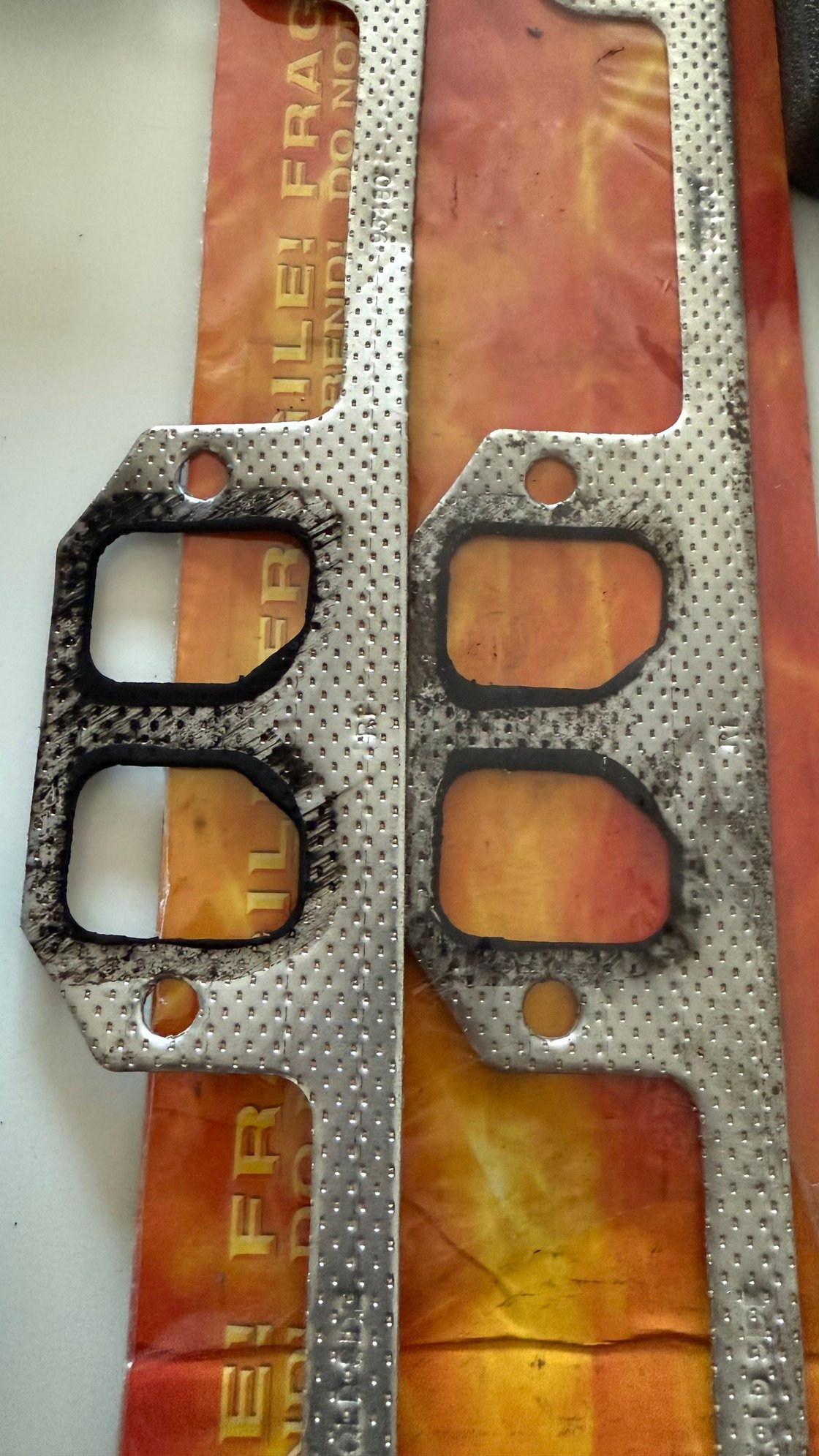

Well on the bright side, I am parts cannoning it and it is fixing problems I didn’t know it had, just not the one I want lol.
When I replaced my exhaust gaskets with remflex ones, I did find I did actually have a small leak
