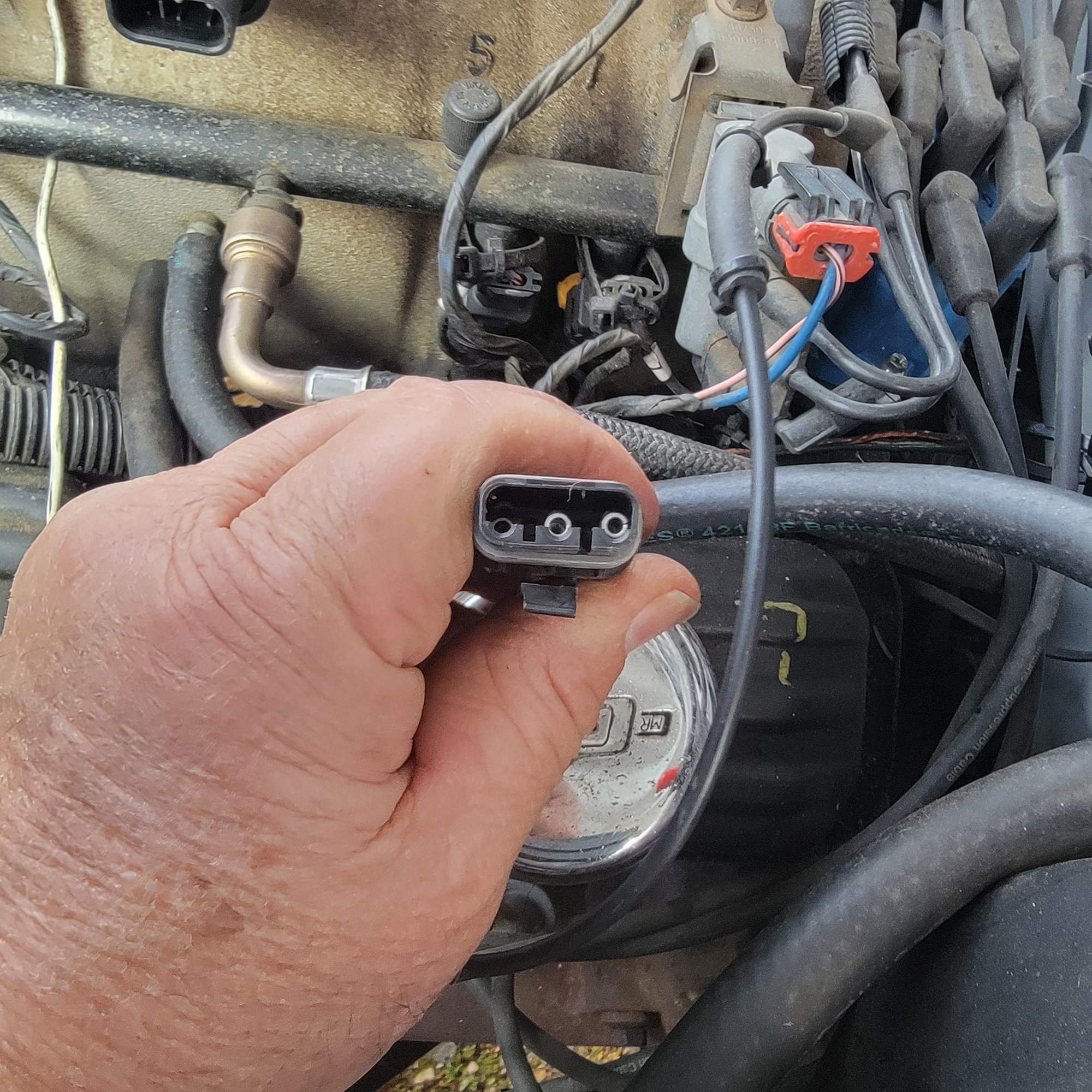

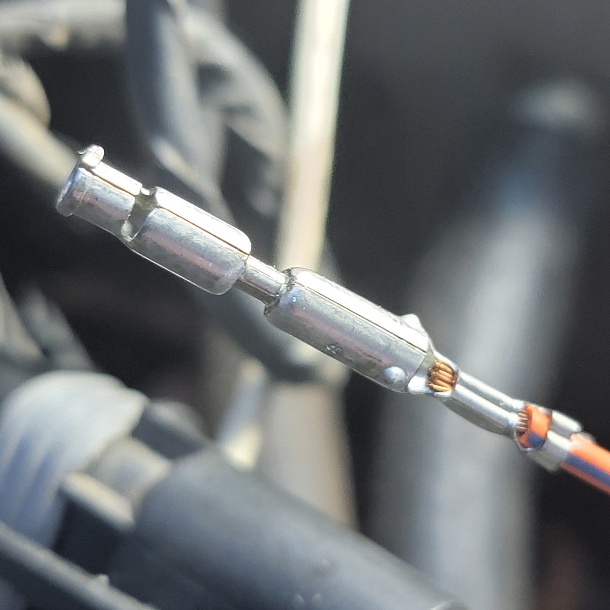

I must of missed the TPS. I inadvertently touch the purple wire on the TPS, and the engine dies! Took the connector apart, kinda like a Deutsch. Does anyone know what they are ? ONLY REMOVE 1 pin at a time or copy it out on paper. Female Split pins were spread a little. Use needle-nose pliers to CAREFULLY pinch them tighter. Pinch, try pin on TPS, and when good enough, replace the pin in the connector before removing the next pin. Fixed the problem. And I’ll try some pics.
Will the Dodge dealer have these pins, I would think so.
Trying to show the little plastic lever holding pins in. Use small screwdriver, lift lever-carefully, use your little finger and ring finger to pull pin out.
Trying to show the little plastic lever holding pins in, under my FAT index finger. Use a small screwdriver, lift the lever carefully, use your little finger and ring finger to pull the pin out.
Carefully pinch this split closeder, just on left end. Then try on male pin on TPS.
Carefully pinch this split closeder, just on the left end. Then try on the male pin on TPS.
