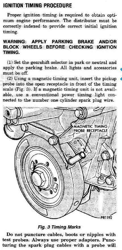

There should be timing marks on the timing cover on the drivers side. You line the mark on the balancer to them. TDC on the compression stroke (#1 cylinder) then see where your rotor is pointing.
