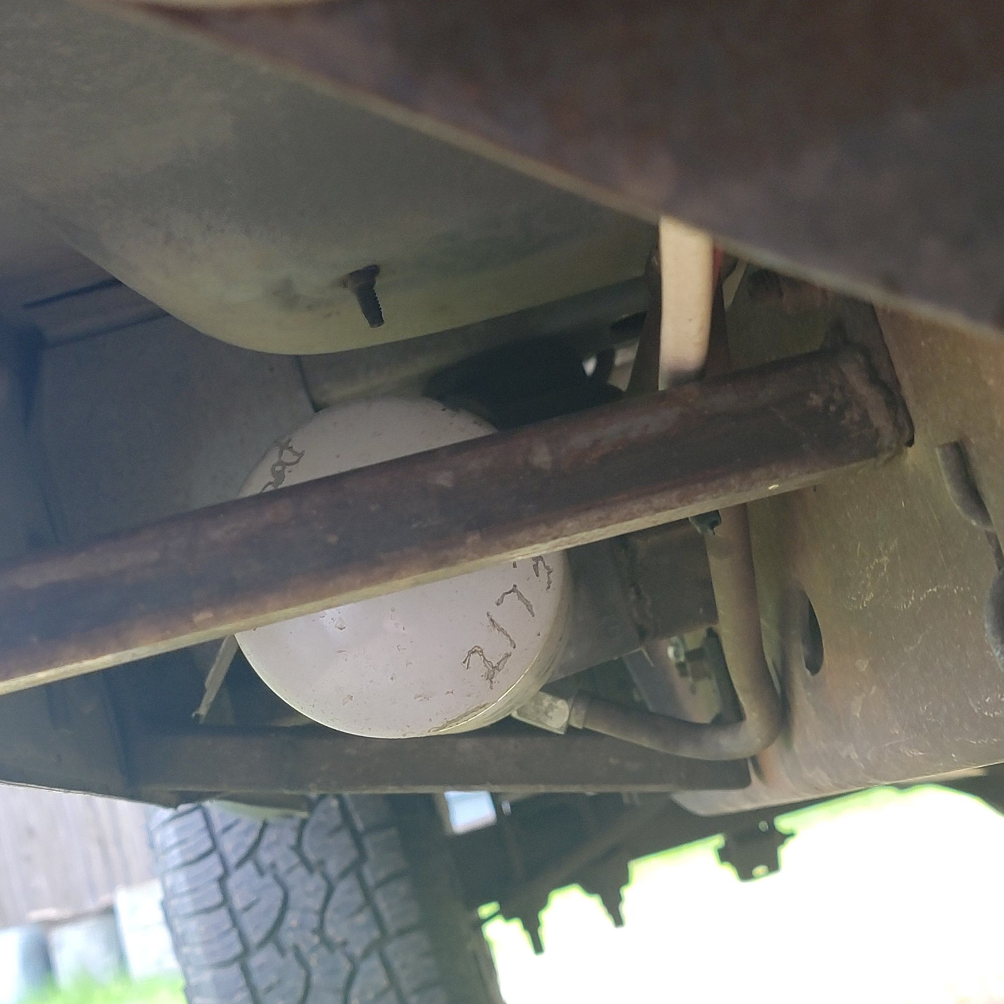

This the engine oil filter, wanted it away from the exhaust manifold. I would bolt a skid plate to these braces, they were easy to bolt in where the frame is a channel. Where the frame is boxed is where I would weld or use nut serts. I guess I should take some pictures of the routing and the fittings. Thats 1/2in .049 tubing and JIC 37 deg hydraulic fittings and maybe the tools I used in various spots.
This the engine oil filter, I wanted it away from the exhaust manifold. I would bolt a skid plate to these braces; they were easy to bolt in where the frame is a channel. Where the frame is boxed is where I would weld or use nutserts. I guess I should take some pictures of the routing and the fittings. Thats 1/2in .049 tubing and JIC 37 deg hydraulic fittings, and maybe the tools I used in various spots. I used a really neat RolAir eccentric roller flaring tool; the flares were so easy, I kept thinking I was doing something wrong.
