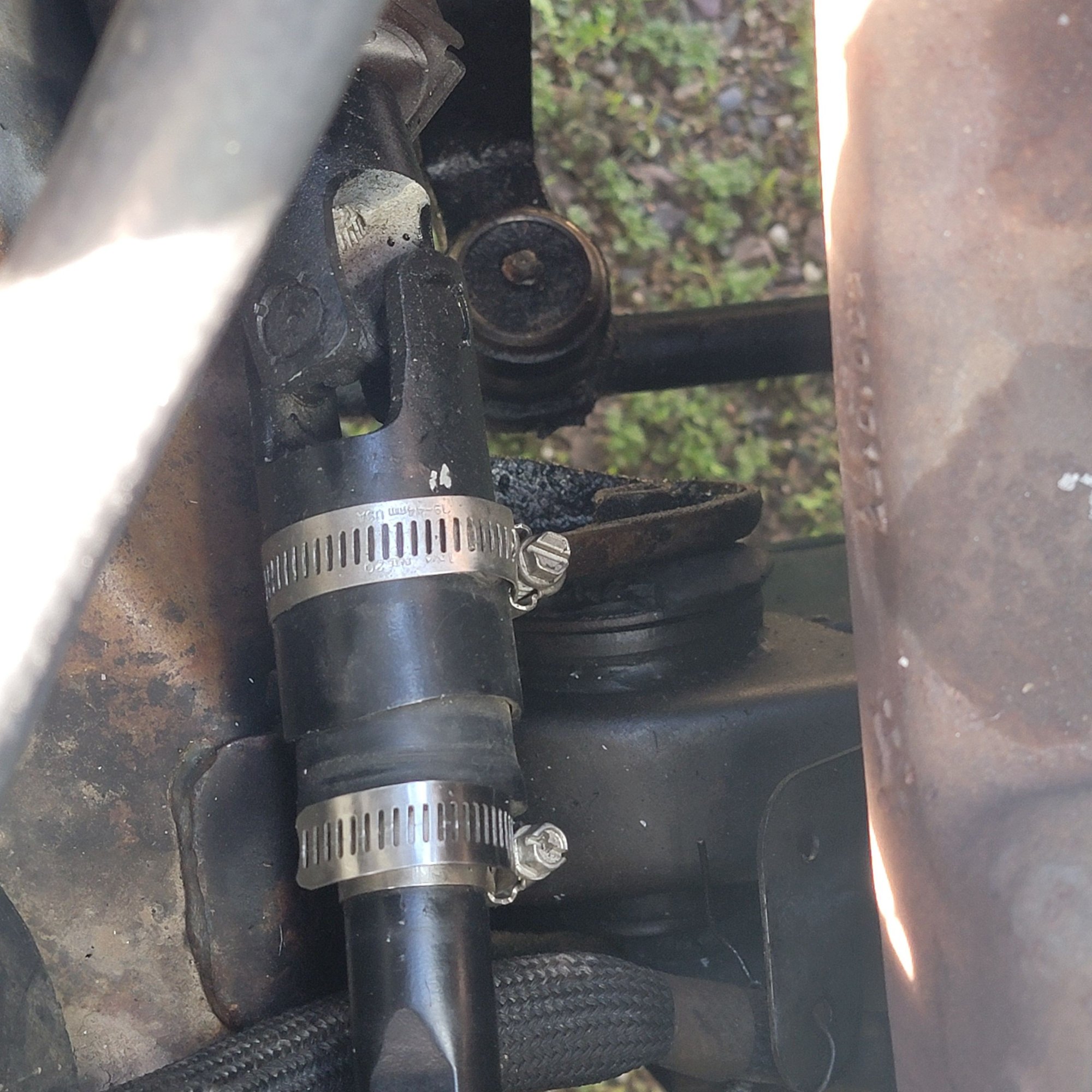

My 94 Dak, 4 x4, extra-cab, intermediate steering shaft, lower rubber coupler started clunking. Found the rubber working its way out. I have a couple of worm drive clamps kinda holding it together. I looked thru the FAQs for a repair and didn't see one. The repairs on u-tube seem to go around 94s. All I seem to find are ones for Jeeps, and other years of Dodges, except for the one where he cuts the u-joint off and replaces it with a new u-joint with 3/4 DD on either end, from Amazon.
Am I missing something? I didnt see anything in the FSM, either.
Where the steering shaft exits the cab, the shaft moves to and fro sideways about a half-inch. Is there a bearing at the bottom that can be replaced?
All of the shafts I see have rag joints. The ones for Jeeps look similar to mine. Any ideas for a replacement or repair. I haven't pulled it out yet to see what the ends are. Like are the both ends splined or double D or a mix? Would one from a different year fit? I'm thinking about splicing and dicing one or two and see if they'll fit. Gotta be a simpler way.

My FSM is for a 93. I haven't found where the spline count is shown. It shows the teardown of a box and shows the stub is splined with a torsion bar sticking out of end. It looks as if mine dont have a torsion pin.
I have a 94, 4x4, auto, Multi-position column with a cage around the lower end inside the cab. So my intermediate shaft is short ( 18.5in).
I was talking to the Lares Tech about the 94 Dakota power steer box Input shaft. He said it was 3/4in-30 spline. Rock Auto shows 26, 30 and 25 spline totally round 3/4in shaft with a flat-bottomed groove midway on the end. My lower end Vibration absorbing u-joint is here
Used a part of a 3/8 pipe to make a shim for roll pin. Ill need to take it off to repair it, or stuff it back together.
Used a part of a 3/8 pipe to make a shim for roll pin. I'll need to take it off to repair it, or stuff it back together.
They are made out of Aluminum, which doesn't stand up to a steel pin beating on it. This is why I'm trying to find the spline count.
