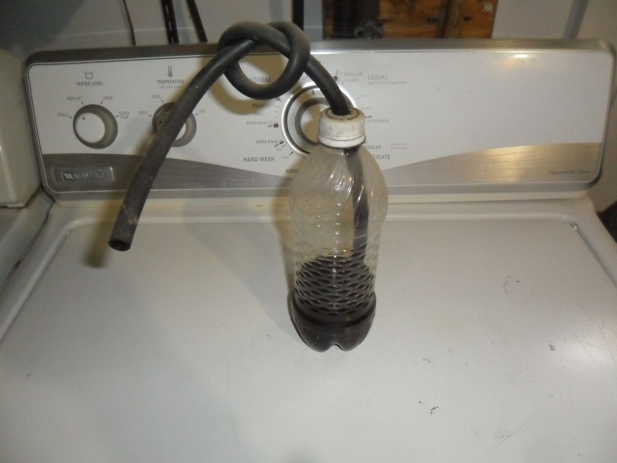

This is my brake bleeder. It stands alone and the hose fits snug over the banjo bolt. Haven't used it since I replaced all the brake stuff not long after I bought it hence the dust. Untie the knot to use.
^^^^ this ^^^^
Been using this method for many years, but I use a clear line so I can see the fluid status. As long as one end in the bottle is submerged in brake fluid and the other end is sealed on the bleed nipple, no air can enter. The fluid at the bottom IS the check valve and it's too heavy to flow uphill, unlike air. You can pump and pump as long as you have fluid in the reservoir.
