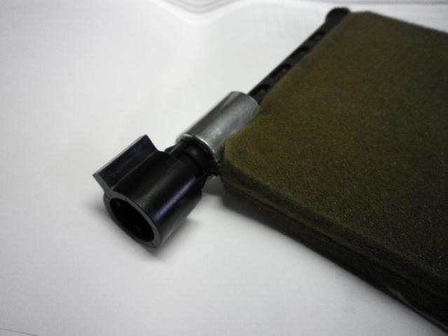

Default Flapper Repair
Found my broken part from my flapper door which looked very similar to the 70cuda pic. Super glued it back together.
Ace Hardware had a 1/2"X1" steel thinwall sleeve (2 bucks) that I was able to slot down the side with a cutoff wheel. I was able to press it over the repaired area of the flapper.
A new coupler (12 bucks) from the local Chrysler dealer and its back together. We'll see how long it lasts.
I also added a support for the coupler stops as I noticed a small crack on one.
DS

Having this same problem myself, Looks like I'll start taking it apart tonight and see what I find. I just hope the repair lasts as long as replacing it, I don't want to have to deal with it again for a long time.
