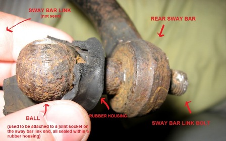

I wish it were as simple as the bushings, but it’s actually the ball joint that’s come out of the sway bar link a.k.a. “dog-bone” (on the rear driver’s side), and the rubber covering is shredded. So something’s gotta get replaced, and if that’s the case I was wondering if the Hotchkis 2246 was worth it?

i think you have something messed up, there are no ball joints on the rear of these trucks . . .

+1 Sharp... i just read that and thought to myself... wtf? balljoints? what ball joints ?

Yes, I know there’s no “ball joints” in the rear, but technically the articulation on the most distal side of the sway bar link (encased within the rubber seal), that connects to the bolt, is a ball joint. If you’ve ever seen one dissected then you’ll know what I mean…actually, here’s a pic of what it looks like (I lifted the image from another forum, but I added the labels):

yup thats a ball and socket joint, (well half of one anyway, lol) from that picture it looks like its part of the sway bar.
