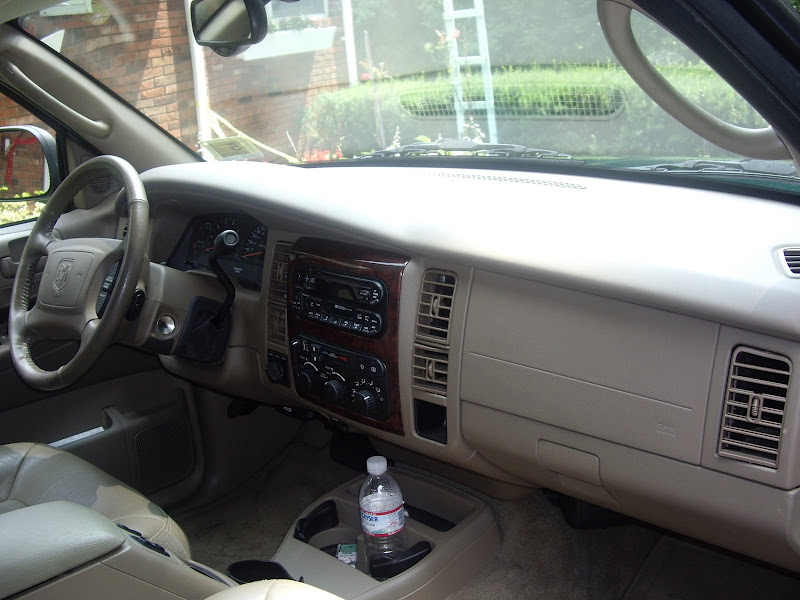

this is true for the 98-2000(i think) but the -2 has a different dash style on it the entire piece from the drivers door over to the glove box needs to slide out in order to get it i believe not fun but i have never done it my dad did it to his when he thought the hvac sontrols were fried(turned out to be a fan resistor lol) the entire thing slides out towards the back of the vehicle
this is the new interior
gl with the install and take pics so that the rest of us w/ the new dash style can see what you did

Just FYI,
Starting on 2001, they have changed the interior of the Durango. Dash, overhead A/C, etc..
