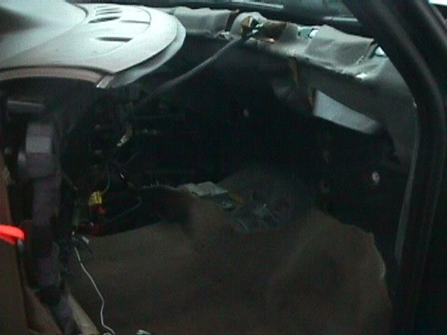

Im too lazy to read into my d anymore, from now on i just rip things out and ask questions later haha. I HIGHLY recomend though that you only remove one side. Cuts your time in half.
