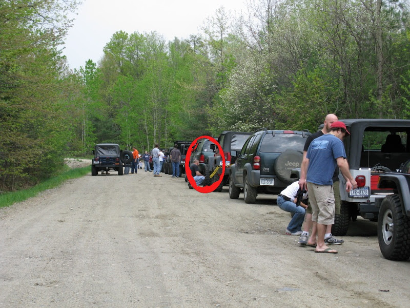

Can you find waldo?

circled in RED ?????????
the one closer to the front of the line of cars
