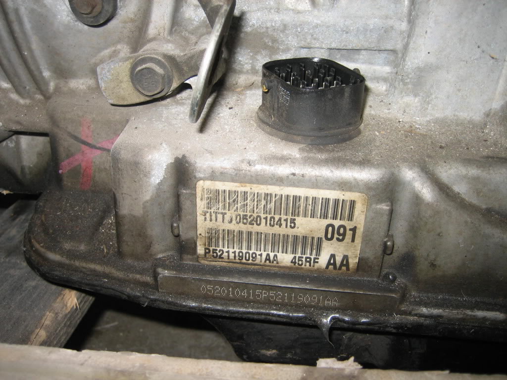

Size:  166.0 KBwill a 45RF interchange with a 45RFE ? someone told me they had never heard of one.. but this one supposedly came out of a 2000 durango. can anyone help me out here?

45FRE trany is the number.
Are we working on a 2000 Durango with the 4.7L 4X4?
And interchange with what?

its a 2000 durango 4X4 and yes a 4.7L that right now has a 45RFE in it that is shuddering real bad trying to get into overdrive. so I picked up this tranny from a 2000 durango that had a blown motor,,,, figured the tranny should still be good..and coming out of the same year and type of vehicle .... it wouldn't be a problem... well now that I have the transfer case out and everything except for the tranny I noticed the only difference between the 2 is the "E" on the last part of the 45 type. Everything looks to be the same even the electricle plug ins. My transfer case even bolt to.
I would hate to install this and not have it work so any help would be greatly appreciated.... thanks

Sounds like a manufacture code.
I'd install it. Call a dealer if you think there's an issue.

The 3.9l had the 42RE.
The 5.2L had the 44RE.
The 5.9L had the 46RE.
The 4.7 has the 45RFE or 545RFE.
As far as I know... The 45RF comes from a Jeep Grand Cherokee.
Since the 45RFE and 545RFE is for the Durango 4.7l and since that transmission is all PCM controlled, I would NOT put in that trans for the Jeep. Who knows what electrical controls the Jeep has that the D doesn't and vice versa. Whoever told you that was from a D is wrong. From a 4.7 yes. A Durango, not likely but who knows how it got there before you got it.

Ouch!
Call a dealer to make sure of the type.

I called the dealer today....turns out it is a 45rfe out of a 2000 durango anyway!!!! dont believe the stickers!!! got this info from the # stamped under the sticker!!! for anyone else that might fall upon the same problem.. thanks for all your guys help!!! I will continue with the install. hey does anyone know if you have to take the exhaust apart to get the tranny out? or can it be done with it in? peace!

Thanks for the update and the added insight. Being from a Durango... that makes better sense. Had it been the 45RF as you stated, it's a Jeep trans. Who knows what would have worked or not. Interesting info on the sticker. Good luck!
