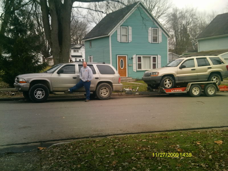

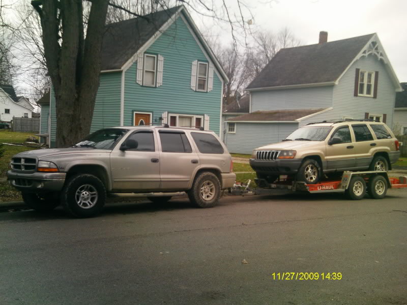

OK... Putting us back on topic..... I just did it again!! Just picked up a 2000 Jeep Grand Cherokee Laredo for the wife the other day. It needs a new Transfer Case thats all. Take a guess what I got it for? Oh yeah... Here are some pics of it on the trailer with the D pulling it home.

If you backed it on the trailer the main weight (engine) would be on the rear, if you could tie it down? I have air bags on my rig to keep the rear up so it don't drop the rear end and it also aids in handling.

+1. Turn that Jeep around.
You should never tow with the *** end of the tow vehicle down AND the nose end of the trailer ALSO down. Dangerous condition for anything other than in-town drivearounds.

Even then, you have no emergency braking power with the front wheels up like that.
Air bags might lift the rear up some but that still doesn't fix loading the tongue too much which is what causes the nose of the tow vehicle to be pointing up.

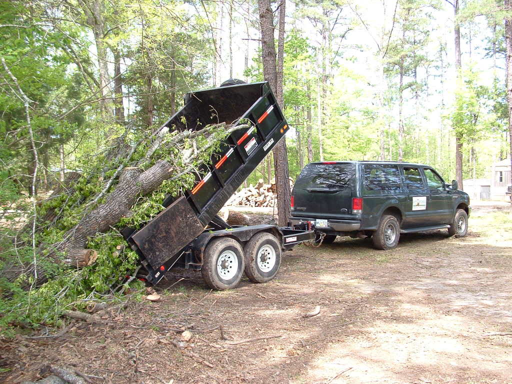

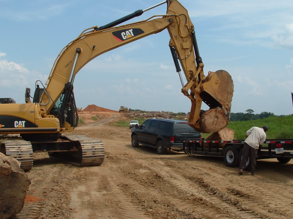

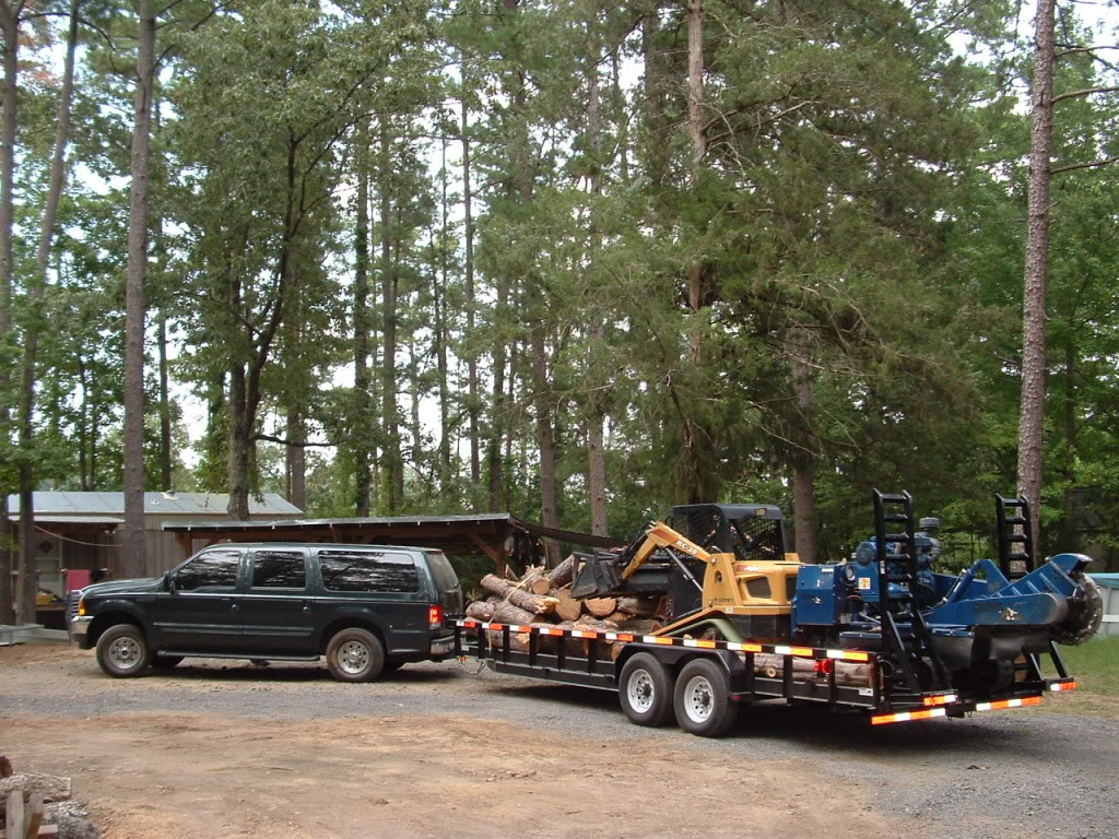

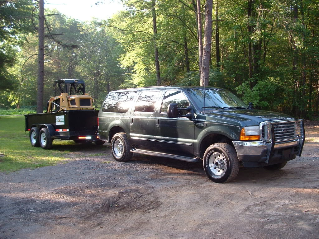

I fixed my Durango up to be able to tow 7,000 - 8,000 lbs daily. New tranny, shift kit, 4.56:1 gears, added leaf springs in rear, new tires, hawk superduty brake pads, bilstien shocks, prodigy brake controller. It tows it quite well or at least I thought it did until I got my Ford Excursion. The difference is night and day.
It wasn't just the power either. The Excursion has plenty with the 6.8L V10 but the 360 Durango with the 4.56:1 gears is no slouch.
The 8,000 # trailer still wags the Durango pretty good over bumps and stuff where the Excursion is rock solid and 8,000 lbs feels like barely anything back there.
The Durango at its best is still a half ton vehicle and a fairly small one at that.
Here's a picture of the Durango pulling my stump grinder and a few others of some things I've pulled with the Excursion. I know this isn't an Excursion forum but this is a towing thread and already way off topic anyways.

Well, I dont haul very much, but I do know that you want the wheels on the ground and not up in the air like that. When we went to go get the vehicle the guy I bought it from tried to pull it from the Tie Rod Adjusting bar and snaped it in half. So there was no control of the wheels plus the vehicle did not drive. So that was the only way that we were able to get the Jeep up on the trailer. There was no place to tie it down to on the back end of the trailer. But I got it home and the D is still running strong.
