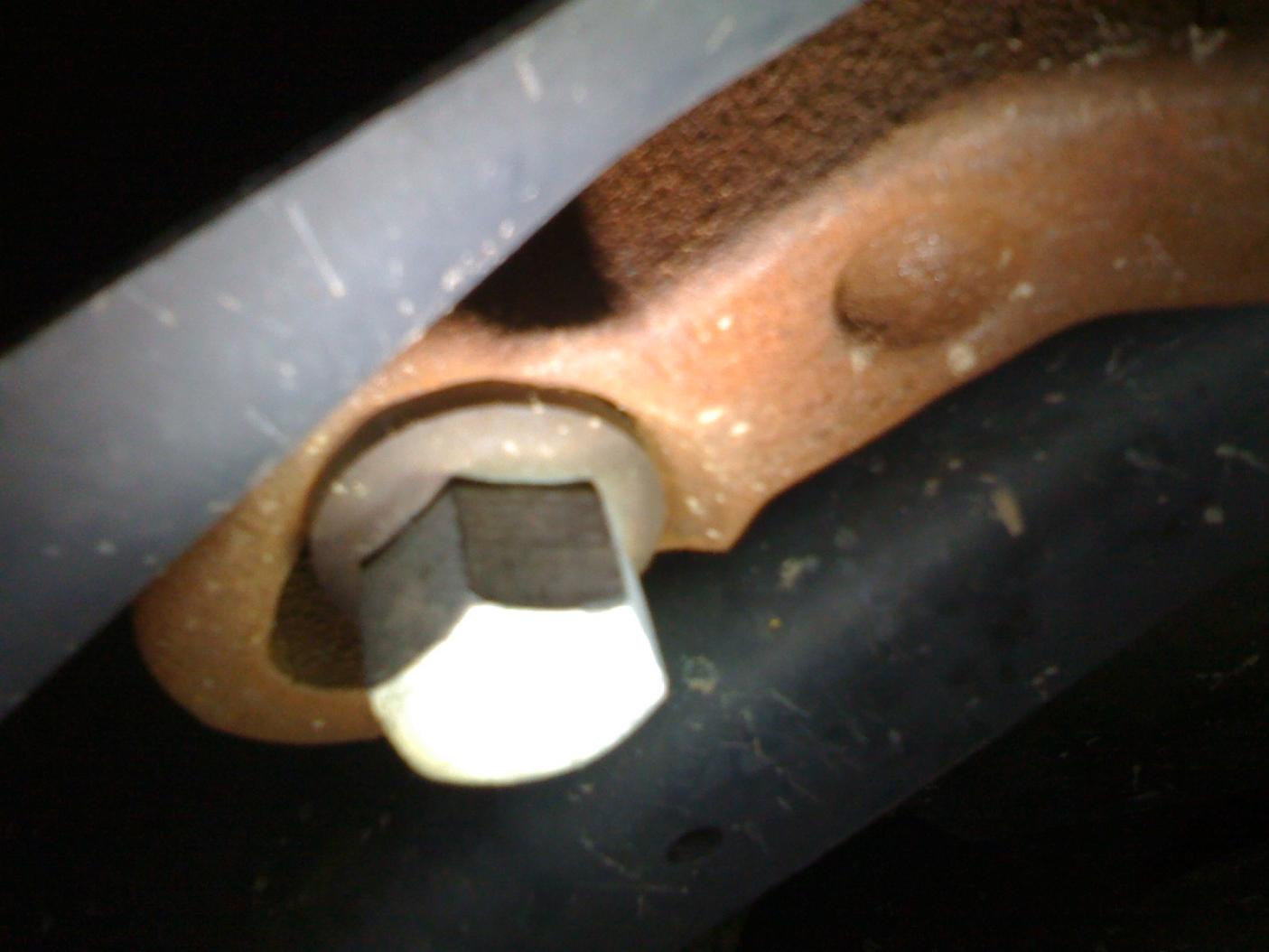

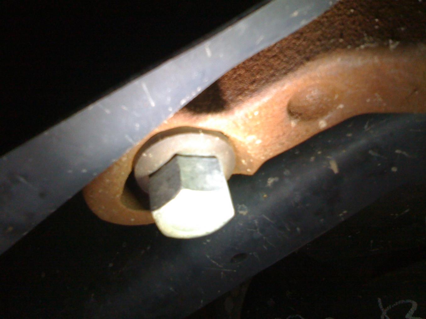

here are the picture of the bolt. the car isnt lifted off the ground tho. if that makes a difference.

It doesn't look like it is fully counter sunk into the cross member therefore you should still be able to turn it in more (crank em). First thing first is you need to make sure the truck is at OEM hieght before cranking 8 full turns.

Same 73mm difference.
The starting point is at OEM height then turn in 8 turns and the shackle or add-a-leaf for the 2" in the rear. This will give you a 2" lift front and back.
