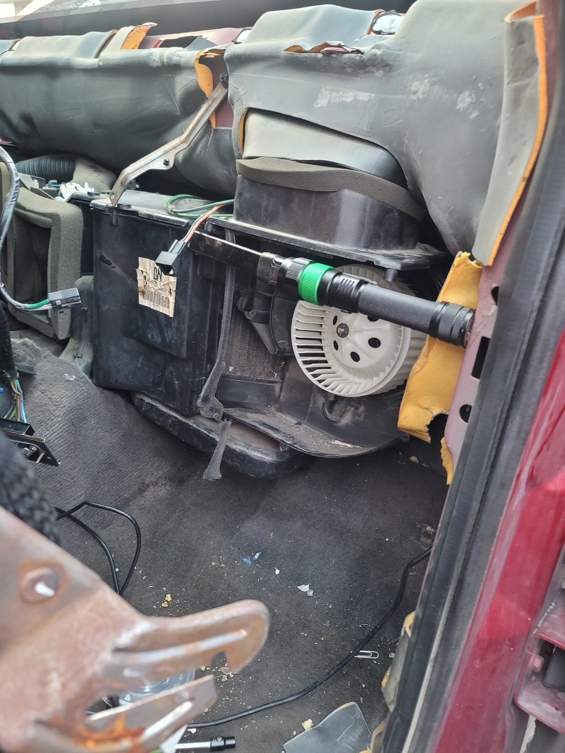

Well, think it was a "perfect sh*t storm" situation....I ended up partially pulling the dash and was able to replace the blower fan and the chewed up wires on the resistor. After lots of cussing and effort she is back together and working great. I also added enough wire to pull the resistor out into the engine bay (donor plug from the junkyard was cut off right at the wiring harness of the donor and spliced at the end of the resistor where the wires were chewed up.
Accessing the fan...replacement already in.
