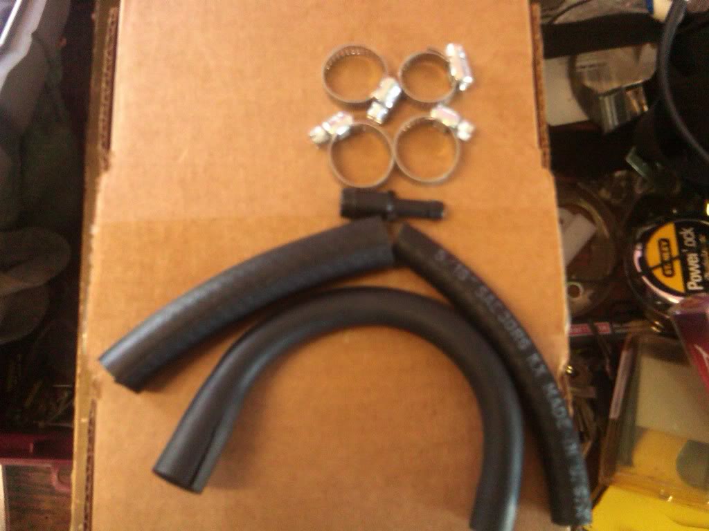

Nevermind Freedog. I found the problem and fixed it myself. I took pics of the problem and solution and everything in between. Pics to come soon.
Old Aug 7, 2010 | 06:10 PM
Durango03's Avatar
Durango03
Joined: Nov 2007
Posts: 321
From: Clayton, NC
Here is what I saw as soon as I crawled under the D.
Here is what I bought at Advanced Auto to do the repair.

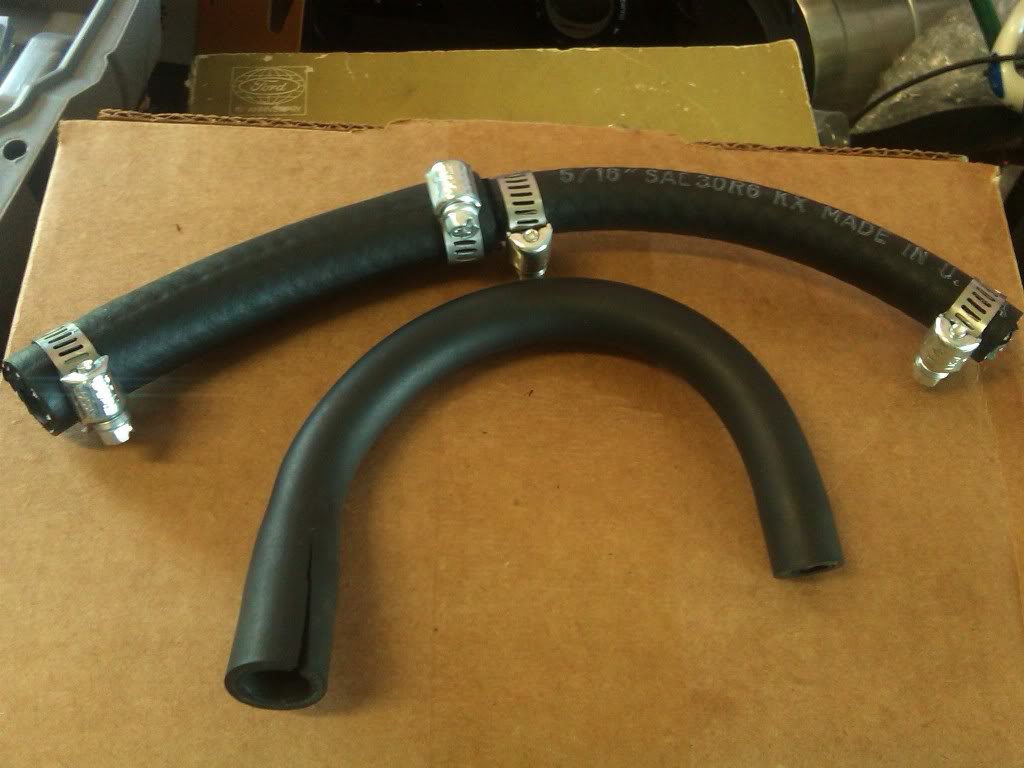

Here are all the pieces in place to make the repair.
Here are a couple shots of the repaired Hose installed.
