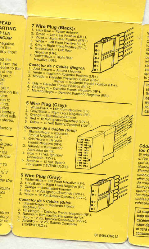

first, always solder wires, and seal the connections with either shrink wrap of liquid electrical tape (my fav method) to prevent shorts.
second, here is the wire diagram, match it up with the on that SHOULD have come with the truck and you should be fine

i have the same issue and was wondering if i had to use the illumination dimmer wire and if so where does it go to on an aftermarket radio. i hooked up all of the other wires that i would normaly use and the headset will eject a cd and display the time if i hit the button but it will not stay lit up or turn on, any ideas?
