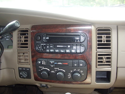

the 2001-2003 model years have an electric switch on the dashboard which you just turn to put it in/out of 4wd, done even have to stop moving to switch it, just turn a simple ****.

The '01 to '03 electric tranny switch is located on the lower left hand corner right below the vent you see in the above pic. I have an '01 SLT so I know. I usually like to engage the 4WD when the road gets slippery by slowing down under 10 mph and engaging the 4HI for driving. 4LO is for getting out of snowbanks (no need to dig the D out Originally Posted by shrpshtr325
