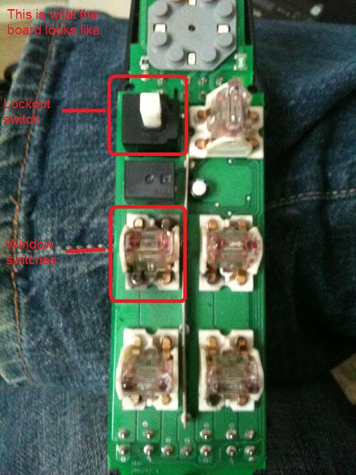

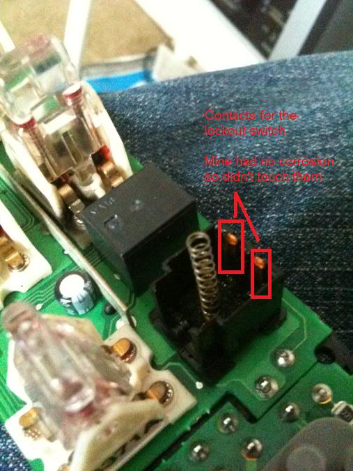

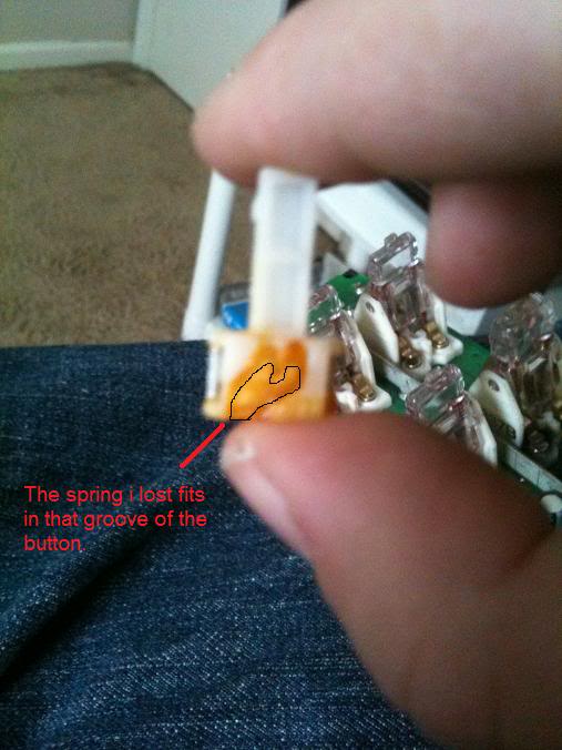

For anyone that is having issues with durango's and their power windows working sporadically on the doors but able to work using the driver's side switches.

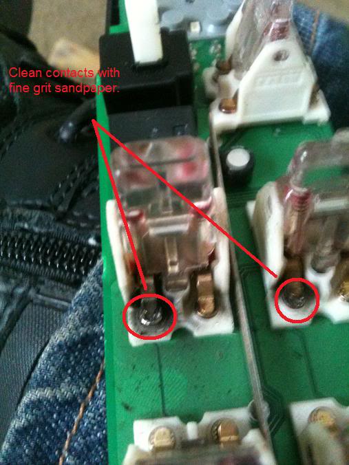

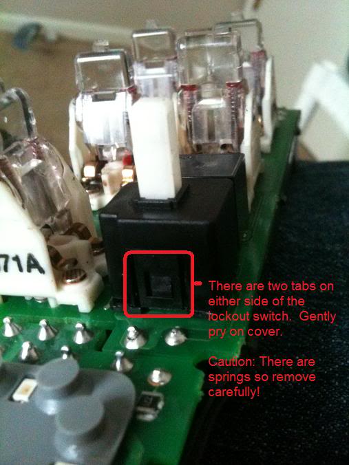

I was not paying attention and pulling apart the lockout button to see if there was a issue with the connection. There are two springs inside the button itself. One on the side that sets the button either on or off and one in the center. I lost the one on the side due to not paying attention and would ya look at that? Now they all work properly. I would not recommend "losing" the spring in the carpet like i did but for me it worked!
While i had it apart i also cleaned the contacts for all switches as well.
If any of you would like pictures let me know.
Why do I get the feeling that this has more to do with them working again than the missing spring?
Old Dec 19, 2010 | 01:14 PM
WhiteWidow00's Avatar
WhiteWidow00
Joined: Jun 2010
Posts: 1,743
From: St. Petersburg, Florida
Amen. It most likely was cleaning the contacts that did the trick and not the spring that popped out...

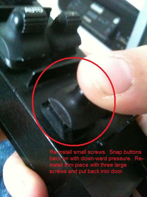

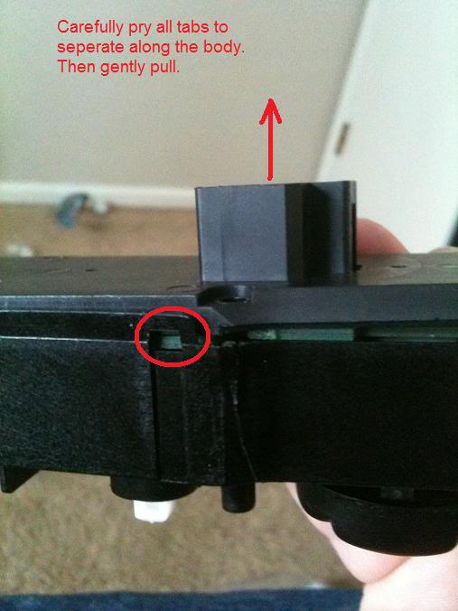

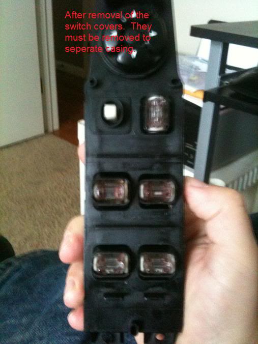

Last edited by Rangochick; Dec 24, 2010 at 10:03 AM. Reason: Put the pictures in backwards heh.
Old Dec 24, 2010 | 10:08 AM
Rangochick's Avatar
Rangochick
Joined: Feb 2010
Posts: 13
From: Yorkville, IL
Sorry for the blurry pictures. They were taken with a phone. I couldn't find the camera.
