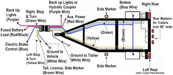

I was looking for a wiring diagram to see if I could figure out the constant 12v to my plug. Anybody know where I could locate that? I'm thinking that maybe I should put a relay in line and possibly decrease the resistance to the trailer with a larger gauge line that is switched by an Ignition on source...

If you look at the plug in on the backside, there's 7 wires obviously, and the black should be the hot 12v lead. For future reference, here is a typical diagram for the trailer wiring:
