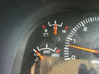

For future reference to whom it may concern, this is where the voltometer should read when all is working well:
