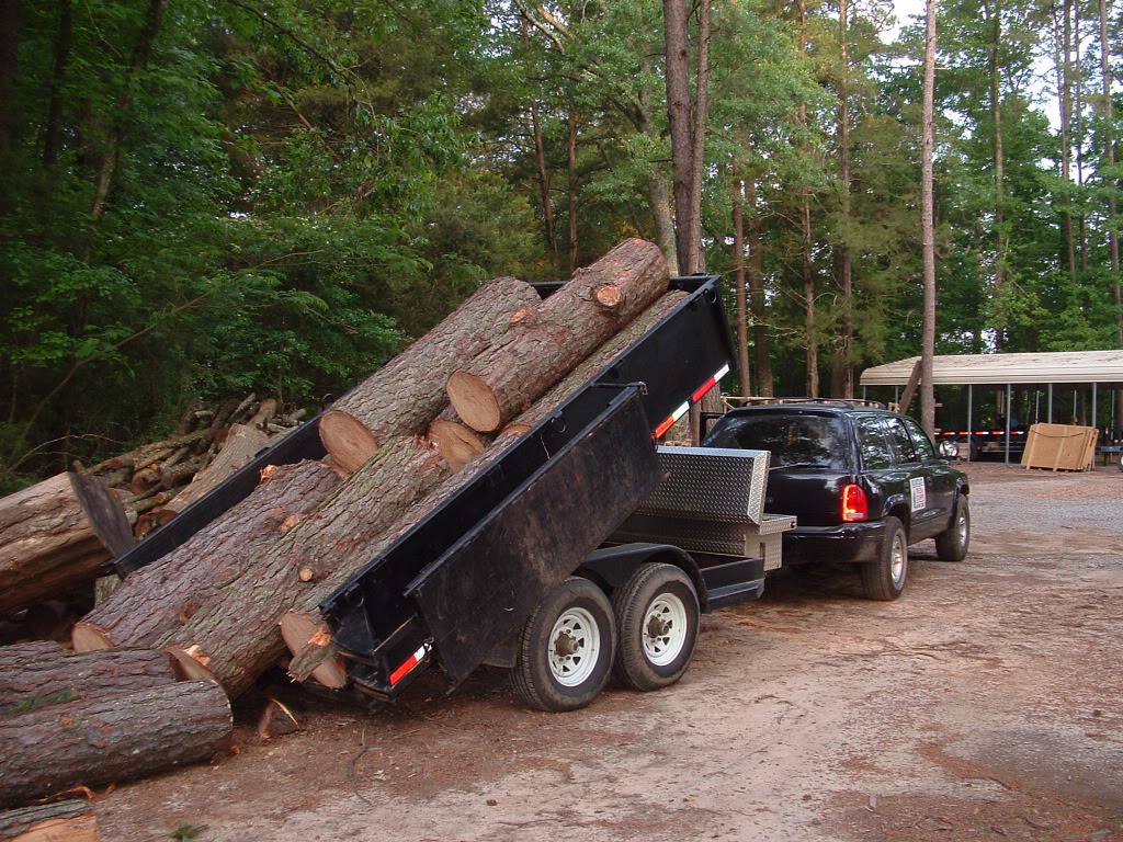

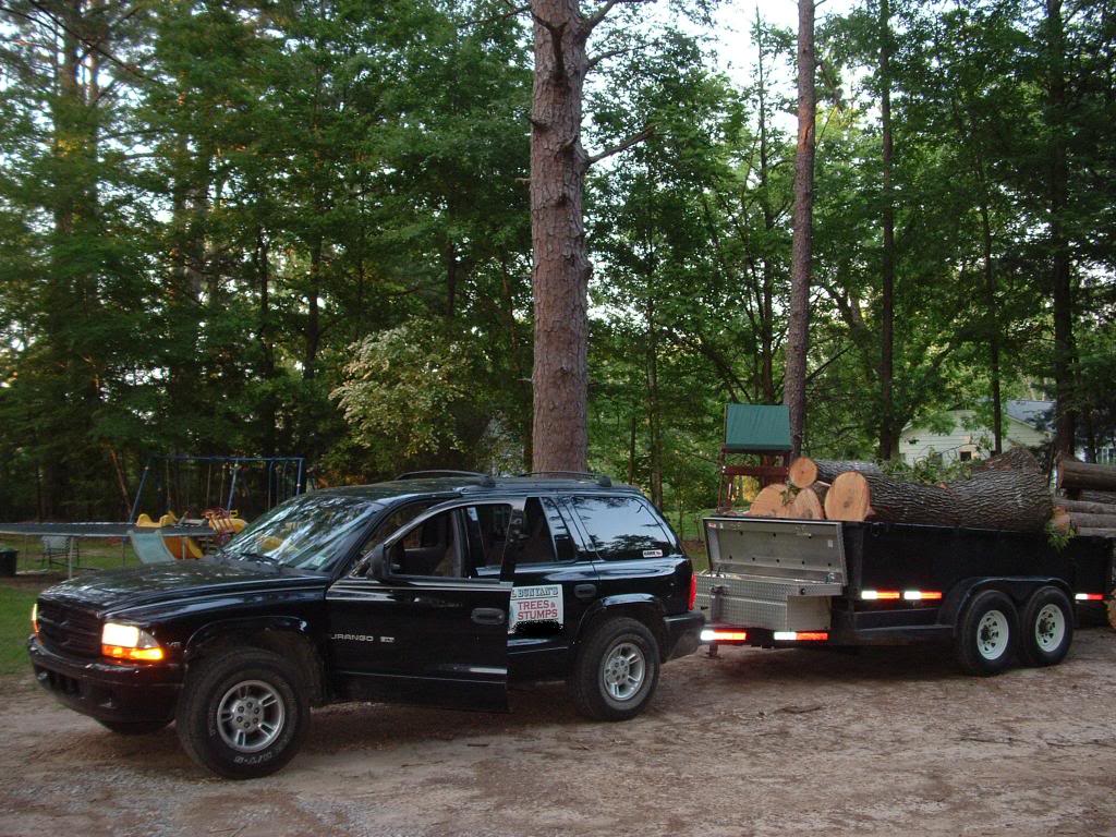

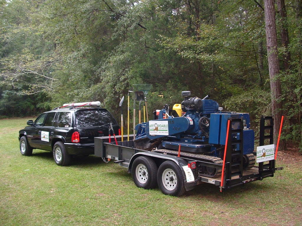

gr8scott72's Avatar
gr8scott72
Posts: 478
Remember, pulling it is only a small part of the battle. You have to control it AND stop it too.
While the Durango can do this, it is still just a 1/2 ton truck. IMO once you get above about the 7k lbs mark, (especially with the large frontal area of a TT) you need at least a 3/4 ton truck.
The difference is night and day between my Durango (1/2 ton) and my Excursion (built on the 3/4 ton Super Duty frame with a 1 ton axle, single-wheel under it.) when towing heavy stuff. That is even considering the stuff I've done to upgrade my Durango (see sig).
(Btw, I rolled onto the scale in that last picture at 32,640 lbs.)
