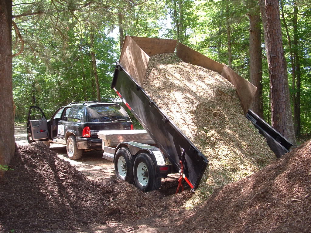

If 4.10:1 gears are the better choice, then 4.56 gears are the best choice!!
I went from 3.55:1 gears to 4.56:1 gears and lost NO mpg in the city. That's right, EXACTLY the same as before. And want to talk about waking it up? WOW!
I lost only 1 mpg on the highway and have taken several trips to prove this.
The towing mpg goes up too but more importantly, the ease of which it accelerates while towing is MUCH better.
I know about towing heavy stuff:
