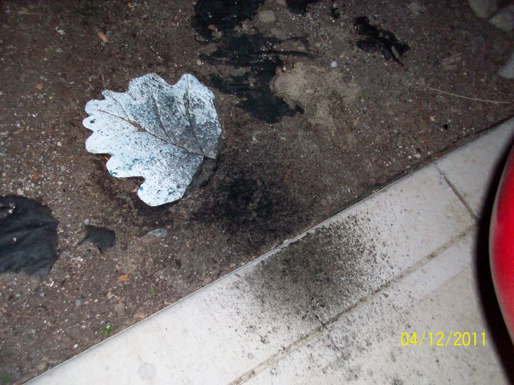

I noticed an insane amount of soot coming out of the tailpipe, I mean like this much:
That first picture isn't nearly as bad as it usually is, I just clean off the driveway a lot, but the second one...well how it gets on the bumper beats me, there's a black trail down my street, there is a TON of soot pouring out of the exhaust which means it's burning most of the fuel dumped into it, there's still an unburnt fuel smell though. I was thinking leaky injectors, but it hold good fuel pressure for a long time and if the PCM is telling me a 38% fuel trim at idle, then it's prolonging the injector pulse.
