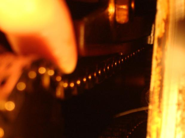

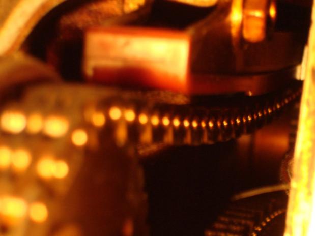

Photos of the left timing chain. Notice the gap between the chain guide and the chain. Third photo is showing how much I can push the chain down.
Attached Thumbnails DIY Timing chain replacement?-dsc03748.jpg   DIY Timing chain replacement?-dsc03749.jpg   DIY Timing chain replacement?-dsc03750.jpg

Right side chain was tight against the guide and the tensioner applying tension. Tomorrow begins the tear down

Originally Posted by Bobman
Hmmm.... the distances aren't as important as the tension is. I suppose it's possible that you caught it just as a tensioner started to fail and the chain was slapping up & down, but you won't really be able to see it without pulling the timing cover.
Consider pulling the drivers valve cover as well and compare the tension on that side. Each side has it's own guides & tensioners, so this may give you some more clues.
If they appear the same, then the only other choice is the third chain, but that's completely buried under the timing cover / other chains. You're already well on your way to a rebuild at that point.
Also, remove your serpentine belt and try turning the engine over *BY HAND* with a socket on the crank bolt. If something is gone south you'll hear it.
4.7's are an "interference fit" engine. If a chain jumps or fails, chances are very good that a piston will hit a valve. You should be able to feel resistance while turning teh motor over by hand. Oh yeah, remove the plugs first so you're not fighting compression.
Keep posting what find, there are a bunch of people on here that can all provide good help.
Bob
Bob,
You were right, it was the one of the secondary chain tensioners. I could compress it with just two fingers. I bought a complete timing set and a new water pump since i've got it a thousand pieces. Thanks to all that have provided input and links.
